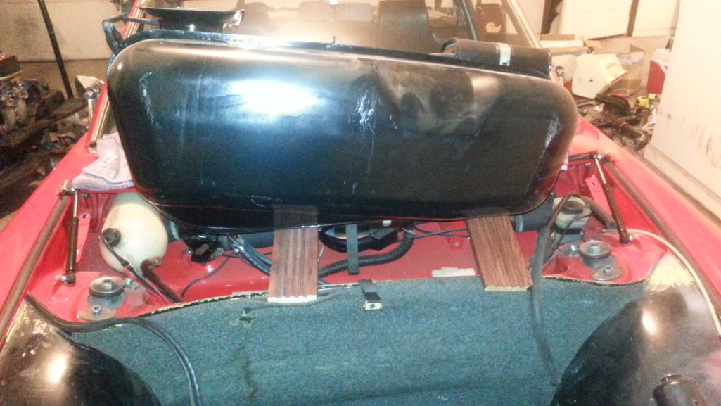

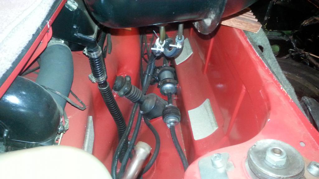

Wrapping up my new fuel lines under the shelf. No matter how many times I have drained/siphoned there has been gas on my face again and again. While it is this "dry" I am thinking I should pull the fuel tank out and check out how it's looking down there as realistically it will never be this "dry" again.
Any reason not to have a peek? Anything I should inspect specifically?

Ya pull the tank, change the plastic lines in the tunnel to stainless and the sock screen in the tank

Why not? I guess so you don't risk finding something that needs serious attention.
Among other things, when you pull the tank check for surface rust on the outside, especially where it sits on the felt pads.

An extra set of hands can be nice when removing the tank. It can give you a chance to change the felt pads if necessary and clean the side rubber ones.

Also check the sides of the tank where the carpet pads touch it. The pads get saturated with water, and eventually the tank will rust enough that pinholes start letting gasoline out of the tank into the pads.
This one drove me nuts trying to figure it out.

If you do decide to remove it the ideal is to have a helper.
If alone, attach vicegrips to the vertical flange on the tank to use as lifting handles

Replacing the fuel lines under the tank with the tank in the car sounds like a nightmare given how small that access opening is.
Pulling the tank is easy- especially with 2 people make the new lines long enough so you can remove them from above in the future. Just watch for kinks when putting everything back together.

When I moved the FP to the front I looped the hoses to/from the tank to allow complete removal of the tank w/o disconnecting hoses. Hoses do not kink and I welded the access hole closed since I didn't need it.

PO put SS lines in the tunnel. Peering into the area it shore looks like they are kinked.
