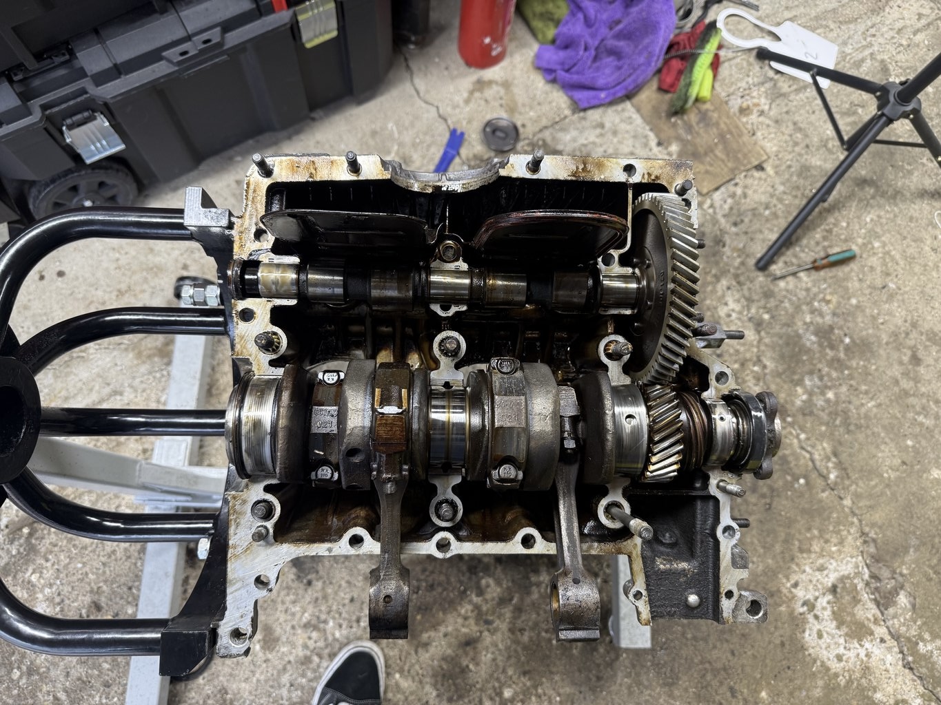

Hi- I’ve followed every thread that I can find and believe strongly that I have removed everything. But still can’t seem to crack it. After quite a bit of wiggling, I feel the case is almost open. I can see that the case is separated almost all the way around the case. That said, I seem to be stubborn around the top.
Any ideas? I haven’t gotten too rough with the case. It’s mostly cracked open, just can’t get it all the way. This corner seems stuck https://imgur.com/a/aeXGqwB

No photos cept’ a single image.
Then imma’ gonna’ assume that a fastener has been missed.

Make sure that the one hidden bolt is really undone. Use some penetrating fluid in spots and on the long studs to make everything slippery. Use a hard rubber mallet to loosen.

QUOTE(Superhawk996 @ Apr 25 2025, 01:58 PM) *
Fair to assume, but, there’s a thread here that shows the location of all. After some more wiggling and some dead blow work, the case seem split all around. I don’t think that can happen with a bolt still in place. I think the answer is more wiggling. Should this thing pop open or can I expect to wrestle this all the wa?

What they said. Do not use a screwdriver or pry bar.
Or use a rubber mallet.
Or use the tool:
https://www.jbugs.com/product/16-9601.html?...585513252260936

We did it fellas!
Looks like the tool required was patience.
https://imgur.com/a/xDZYCBb
This heads out to LN engineering next week.

Trust me - you can definitely get the case spit a little on one side if a bolt isn’t removed on the other. Bad things then happen when the screwdrivers and big hammers come out.
Glad you did have them all out and proceeded cautiously (IMG:style_emoticons/default/smilie_pokal.gif) Good job!
