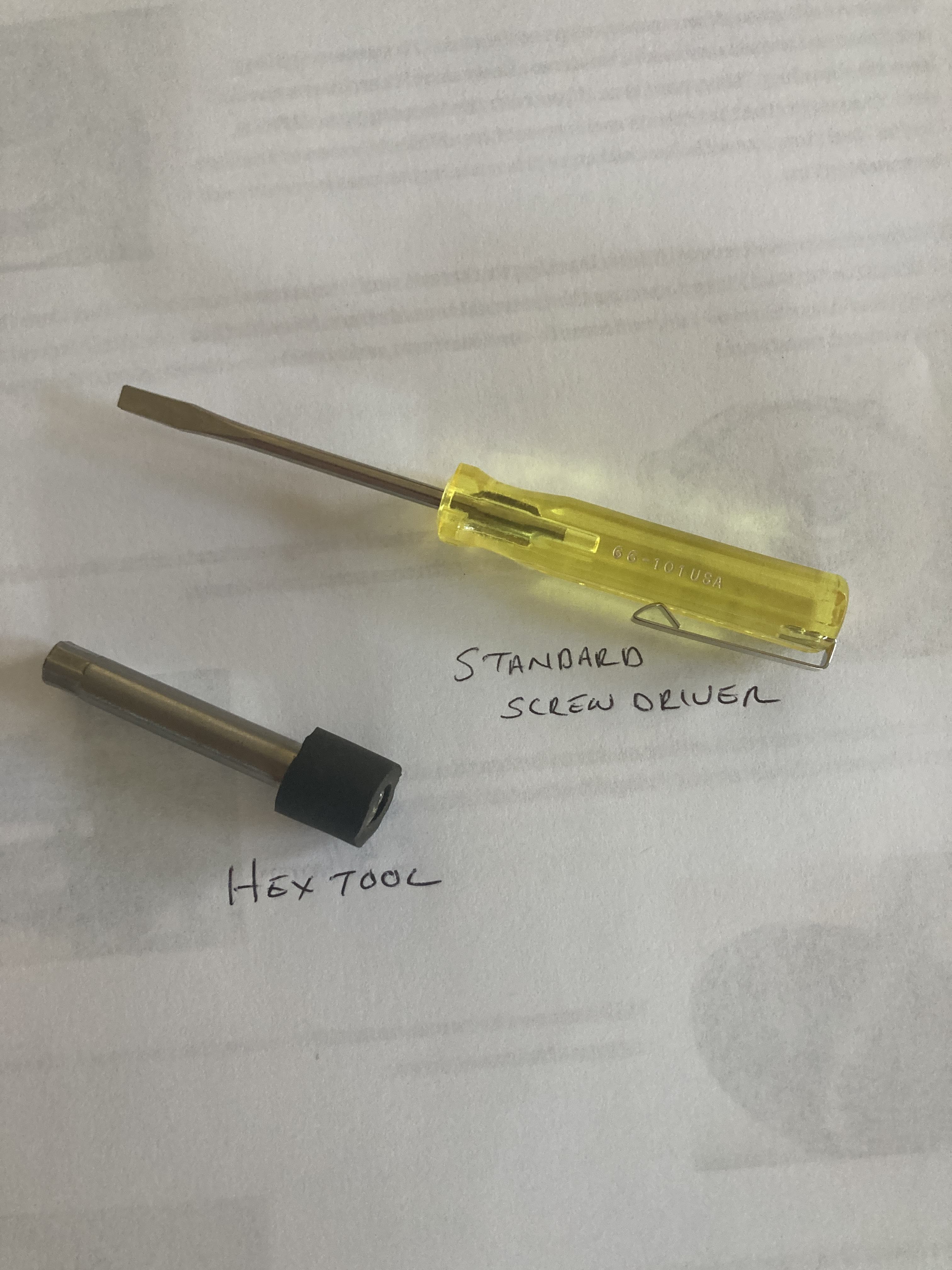

For the tools I have with the kit pictured here . This just looks like a standard screwdriver (nothing special ) and the other is the hex tool , is this only a tool or is it also installed as a replacement part ?

The hex tool is used in conjunction with the screwdriver.

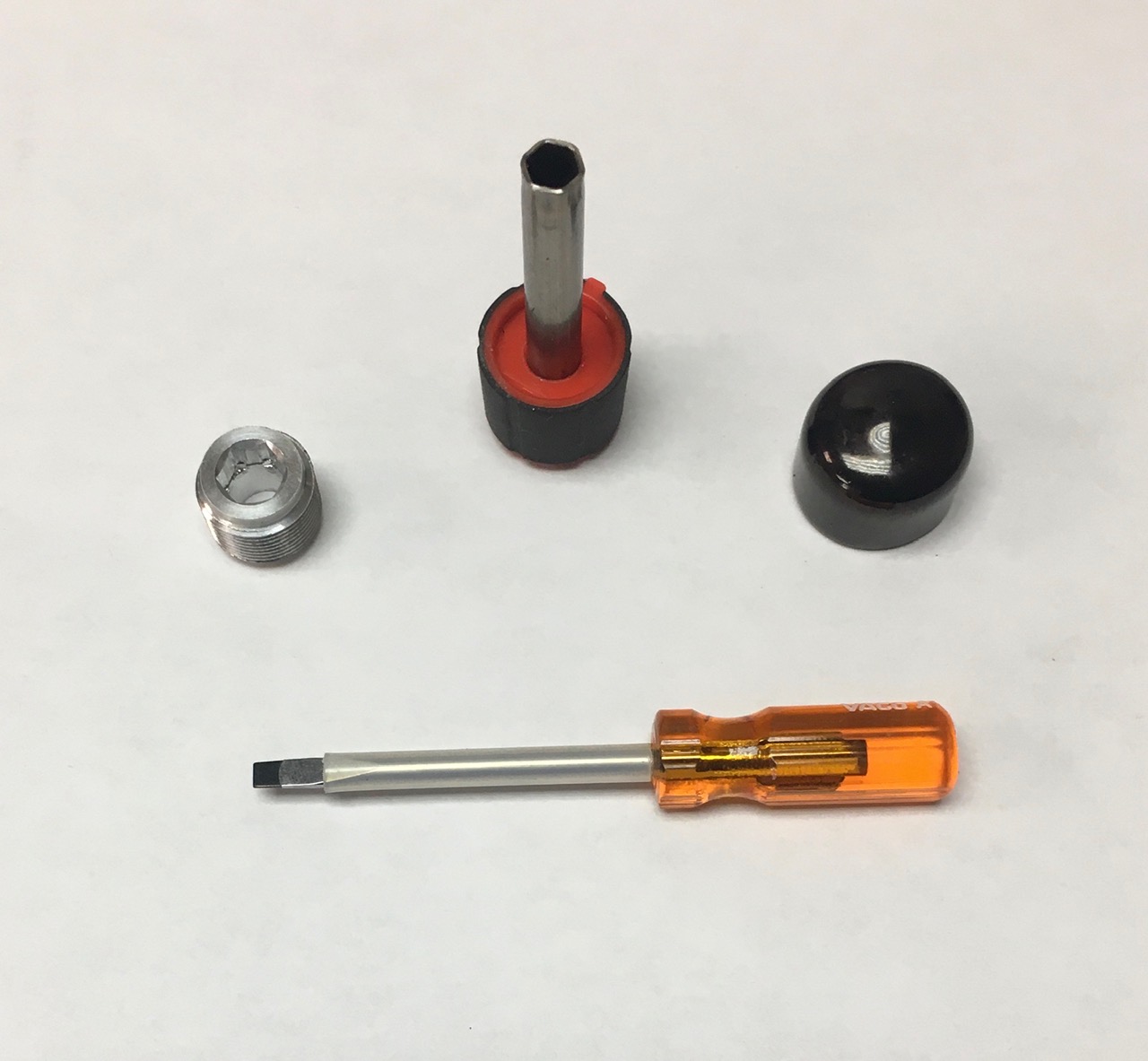

That's an old tool set pictured. Currently, I shorten the handle of the flat screwdriver so it will fit in the engine compartment better, and I sleeve the shank with hard plastic tubing to help keep it centered in the hex tool. The hex tool now has a nice knob on the end instead of a glued on piece of rubber tubing.
