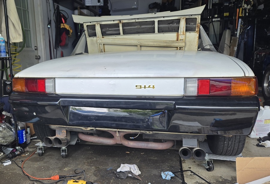

*****Update**** No longer a 6 conversion project, maybe in the distant future, but lets get this off the lift and driving again.
I figured since I finally started shelling out money I would begin a build thread. No set timeline in mind, maybe by the Sept ski roundtop swap meet??? I hate having a pcar down, BUT I have a Rallye and family trips coming up, plus boating season will be starting, just a lot of things going on. I may try to do some vids of the build as those are always helpful to me. Raw footage of me in boxers and flip-flops dropping an engine and trans is always a treat (IMG:style_emoticons/default/cheer.gif) ....Ok, enough blabbing on about life, down to the meat and potatoes.
1974 Ivory White 914. Going to assume it was a 1.8, by it not having fog lights. Idk, I just came up with that theory. "You know Nick, some of the 914s in 74 could have had the 2.0 without the appearance package" She's a basic B is what im trying to say. Too high of a vin in case you were wondering Jeff. Bought her off another world member, Don, down in Charlotte. It was sporting a 1.7 dual Carbs setup with 75/76 heat exchangers and a monza muffler. Black Forest racing did some rust repair years ago, back half of the floor pans. Anyway, I bought a one way ticket from Baltimore to Charlotte and drove her home. She made it eventually and I did not baby her.
Once home I began to go over everything. Rocking 8 spoke empi wheels, rear reflector bar, primer spray in some areas, cracked targa. She was a driver, but she was mine. I immediately began formulating what my plans were.

@shivers - this is a one piece fiberglass bumper. Recently purchased the front and rear from a pelican member in FL. 916 bumpers will be in the classifieds soon.
@root_werks - I remembered that, but forgot the relay board. Luckily I noticed during the separation before it was stretched.

Making some steady progress on not only the 6 conversion but also the 5.
Pulled both rear hubs and bearings. New ones arrived from Mark.
With the motor out I gained access to the bay. I already ordered the tangerine SS return line. Since the car was converted to carbs no need to replace both. Going to CIS it will be required.
I removed the relay board and mount, the blower mount and the brake proportioning valve and mount. I will not be moving the valve like I did in my other conversion. I'm going to use a "T" and make it simple (flamers welcome).
I removed the engine lid as I need to repair the passenger mount. Someone did a fix before and it was poor. A new one from restoration will do the trick. I did this on my other conversion as well.
