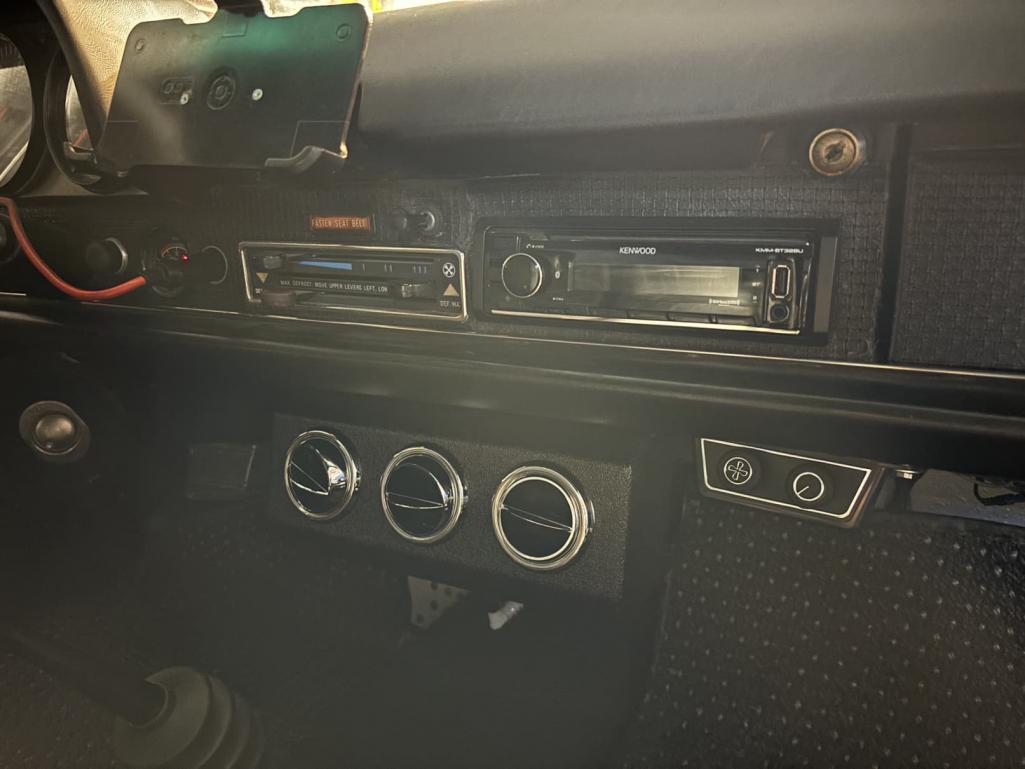

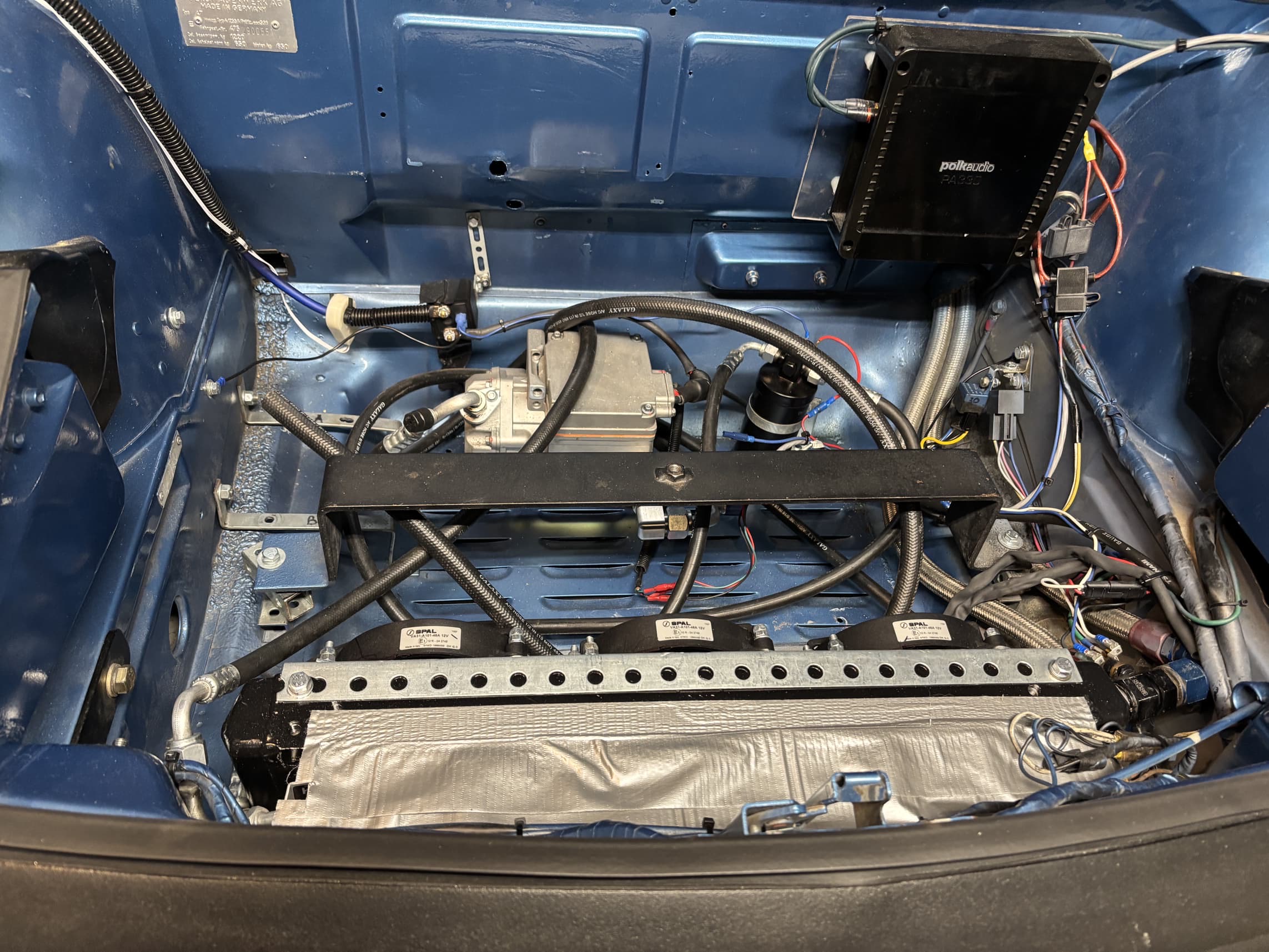

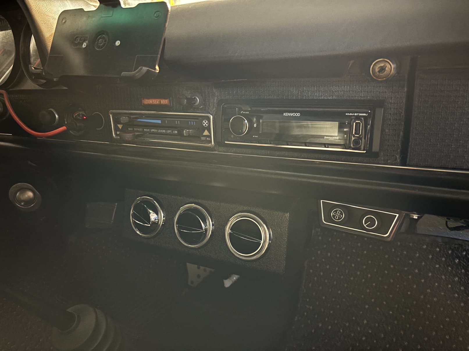

We installed some of the first classic retrofit electric a/c kits back in 2016. The pics of the orange car on the site are ones I sent him almost 10 years ago. Don’t bother trying it without a wosp high output alternator. Regardless of cabin size, using a stock 3.2 alternator is inadequate- BTDT
