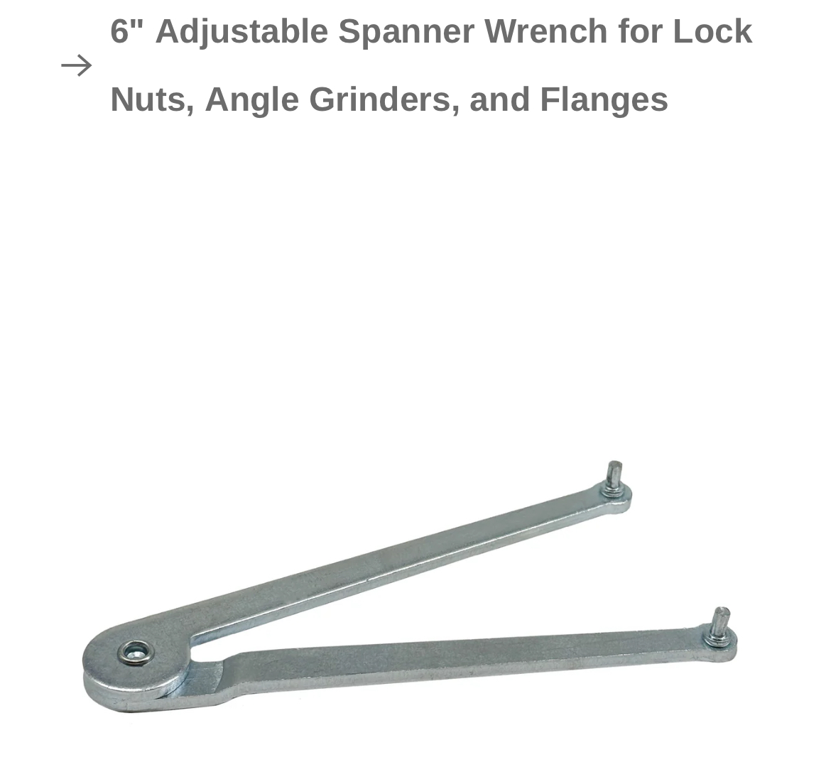

The first tool I would grab is an adjustable pin spanner

They make what is called a locknut socket. There are many different sizes and depths. The linked one is probably not the right one for your application, just an example.
I did a basic 3D design and printed it to get the one off our 914-6 glove box. (IMG:style_emoticons/default/smash.gif)

I took a nickel & notched it out to the desired shape, this just grabs 2 not 4 lugs however.

That looks like an antenna nut (the 4 slotted nut yes?). Try purchased an antenna nut removal socket or wrench.

ooh. never heard of an antenna nut tool - but I see them now. thank you!
