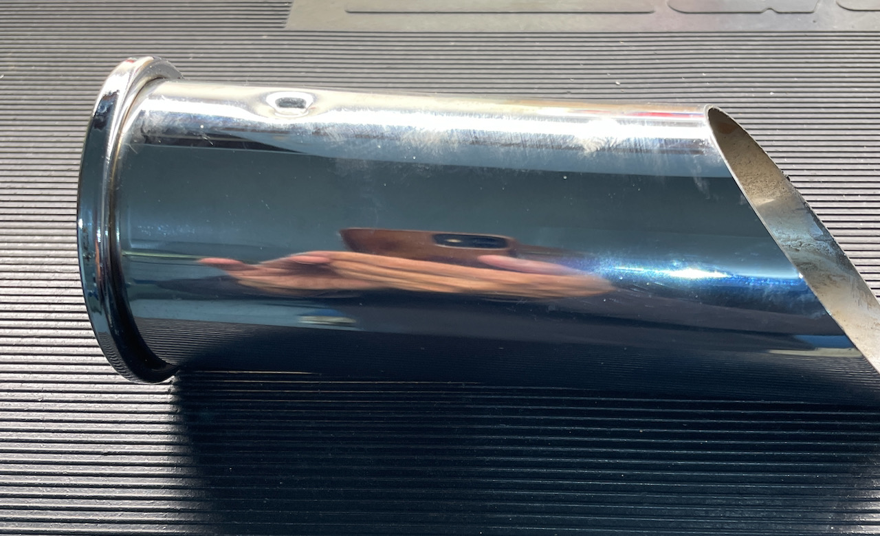

Here's what mine looks like. Top view/bottom view. No idea if a 'factory part'. Installed by the Dr when AA did some work on my car 35 yrs ago. Just swapped the muffler for one of Ben's a couple years ago so this was on the shelf.

Here is an original 914-6 exhaust finisher (tip). It has almost square shoulders on the tip. The reproduction tips we usually see are more rounded on the tip adornment.

Can you each provide dimensions of the diameters and lengths (short side & long side)/? Enough to create a dimensional drawing?

Best I can get from mine: (tip end appears 'square' so may be a factory part)
caliper I have is US only
Rim thickness 0.160"
outer diameter of rim 2.700"
outer diameter of pipe 2.540"
inner diameter of pipe 2.400"
short length of pipe 10.5 cm (to lip edge)
long/point length 18cm

@fixer34 - I believe, based on the photos, your tip is an original 6 tip.
