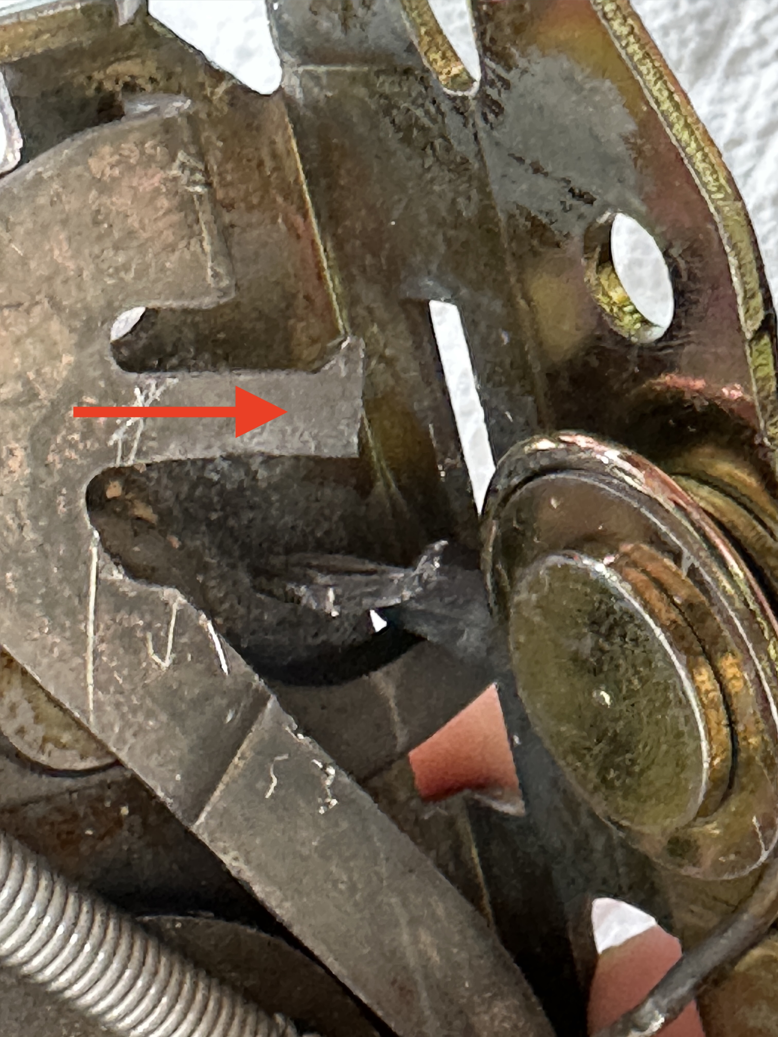

Thanks, guys. Here is an annotated version of the photo that shows what I think is going on.
The dashed red outline is the locking plate. This is attached to the main latch base only at the bottom (right side) by a permanent rivet, with the large circular washer. The locking plate shifts up and down (left and right--red arrows). The locking plate also rotates around the rivet, which is how lifting the outer door handle unlatches the closed door.
As it does so, it also rotates the lever (dashed blue outline) which then moves the long rod on the door forward or back (blue arrow). The rod connects to the inside door lock button that either sits flush with the inside handle or pokes out. Of course this linkage also works in reverse, and moving the inside lock button moves the rod which moves the lever (blue outline) which shifts the locking plate (red outline) up or down.
The green arrow shows where the locking plate and door bar level meet.
First of all, what mad scientist came up with this design? Did the Porsche/Karmann families have some clever but insane cousin they kept locked in the basement?
Second, the resistance to shifting the locking plate seems to be (1) the lower pivot (rivet), (2) the pivot for the locking bar rod lever, and (3) the drag along the long rod and and internal door lock button plus the miscellaneous contacts of all the parts. On this latch I am pretty sure the lower pivot is pretty loose. I am not sure about the rod lever pivot. I will check that out. My concern is that twisting the key, which rotates the little arm on the inside of the cylinder, has to do LOTS of work, and can bind.
Third, do I really need the internal door lock button to function? If not, at least I can at least disconnect the rod, and the drag of all the stuff "downstream". I could even disconnect the rod lever (as mlinder suggested)--just by removing the spring?

OK, I decided to try some new ideas.
First, I will try the passenger door without internal lock/unlock function. I can still do that from outside with the key.
Here is the lock in stock form, with the lock rod pivot spring in place. The end of the spring (green arrow) traps the tab (red arrow) that is part of the locking plate. With the tab trapped to lock or unlock the latch, the pivot rotates and also moves the rod that goes down to the internal handle. In this state, the locking plate requires a lot of effort to shift up and down.
bkrantz
post Jul 10 2025, 07:50 PM
Posts: 8,675
Joined: 3-August 19
From: SW Colorado
Member No.: 23,343
I pulled and twisted the spring (green arrow) so that it no longer traps the lock plate tab, and it also releases the torsion on the locking rod pivot.
bkrantz
post Jul 10 2025, 07:55 PM
Posts: 8,675
Joined: 3-August 19
From: SW Colorado
Member No.: 23,343
Now the locking plate and tab (red arrow) can shift without moving the pivot. This cut the resistance in shifting the plate by more than half, and that's without the rod and linkage to the internal lock button.

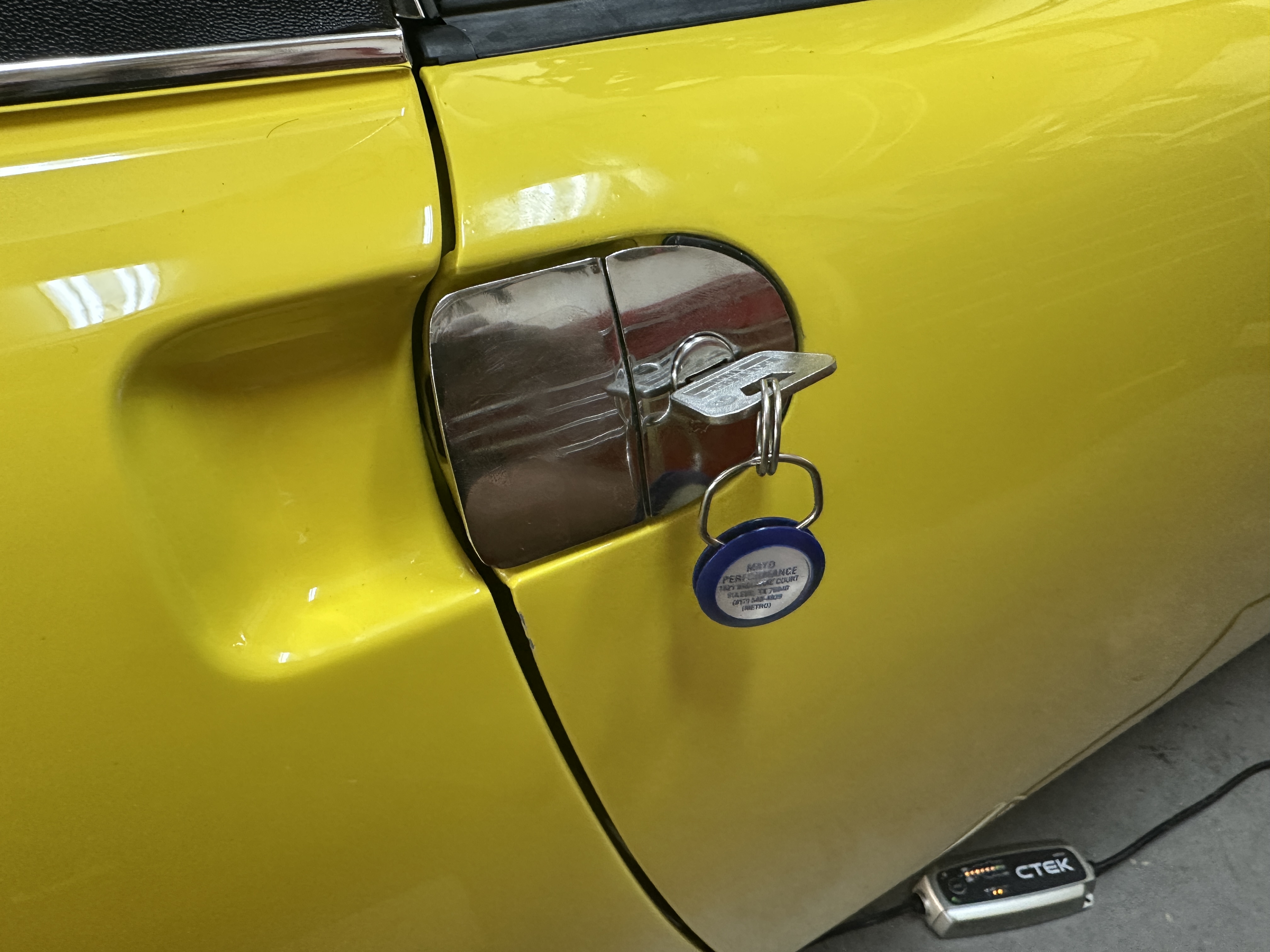

bkrantz
post Jul 10 2025, 08:08 PM
Posts: 8,675
Joined: 3-August 19
From: SW Colorado
Member No.: 23,343
External handle installed--and tested.
Seems like I got what iI want. Using the key is very easy to lock and unlock the door. The internal lock button does nothing, but the internal handle opens the door as always.
