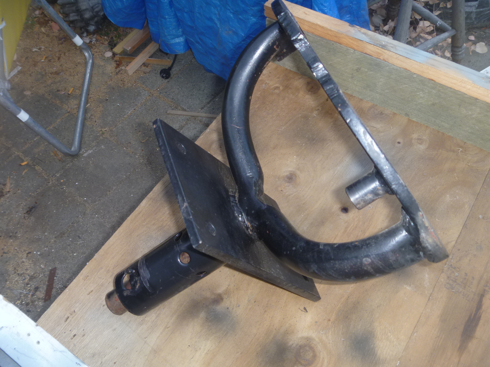

I am not affiliated with this seller!!! I just found this while poking around on thesamba.com.
https://www.thesamba.com/vw/classifieds/det....php?id=2712920

You could but as an engineer I'am not that fussed with the construction TBO ,I built one years ago but used steam tube and basically designed it off the VW tool .
Mine takes T1 ,T4 and 911 with zero sag using 12mm steel for the bellhousing ring unlike the one shown.
Only my thoughts so take it as you like...cause it's not my expensive engine on the that mount if you get my drift ,cheers.

Not acceptable for 914 use. You need at least 3 or 4 arms.
