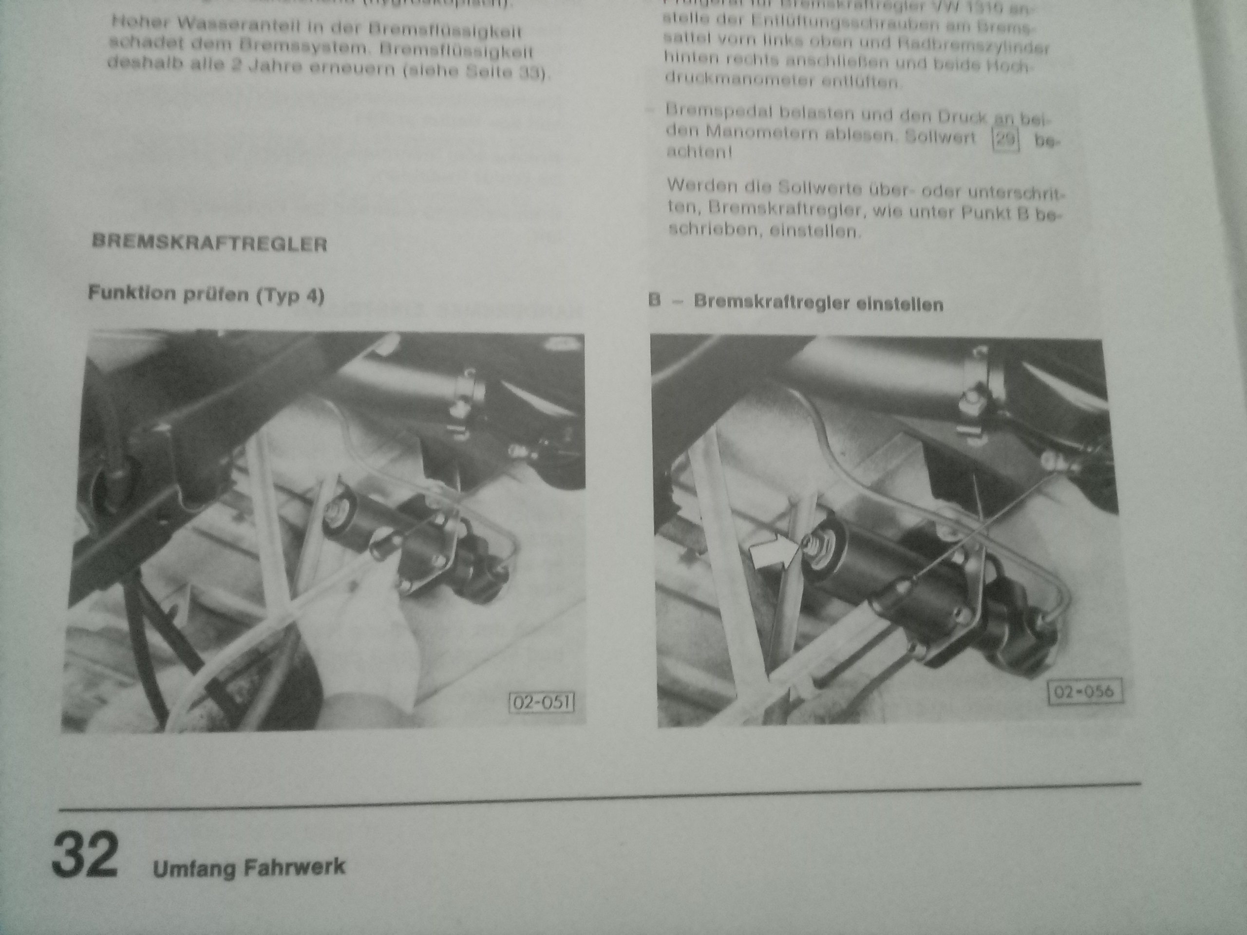

Attached Image Attached ImageAttached Image
George, this ist what the manual said.
Use only a good working or refurbished one.
If you use big brakes you will use different caliper sizes and won't need ist anyway.
