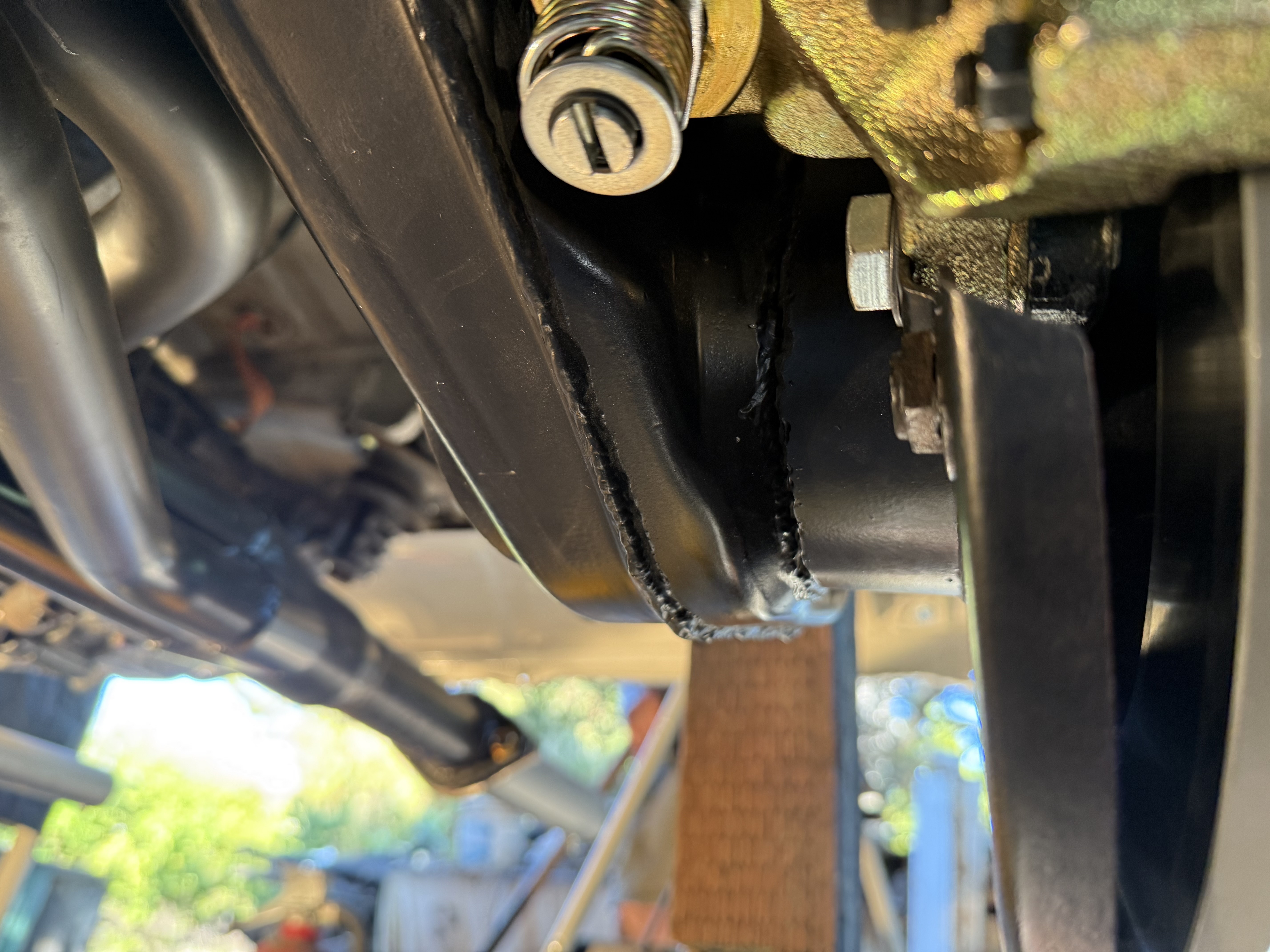

Hey everyone, quick and stupid question I am not seeing an obvious answer or video to and just want to be sure. Is the order of the rear caliper supposed to be as follows from inside to outside:
These are 914-6 Calipers from PMB with associated rotors, pads, and hardware.
Bolt->washer-> bracket for dust shield->caliper-> trailing arm?
Was planning on using blue locktite and torqueing to 50 ft/lbs.
Attaching photos to help illustrate.
Waiting on my rotor retaining screws as well so if you notice them missing, thats why.
If you see anything funky please let me know!

Nope!
Bolt->washer->caliper-> bracket for dust shield-> trailing arm
Please update your profile with the VIN of this car and associated data.

QUOTE(davep @ Jul 2 2025, 06:37 AM) *
Nope!
Darn it! its okay it needs to come back off anyway but good to know I must have had the bracket for dust shield on backwards or something then.
I updated the vin info- hopefully that gives some decent history of the car.
