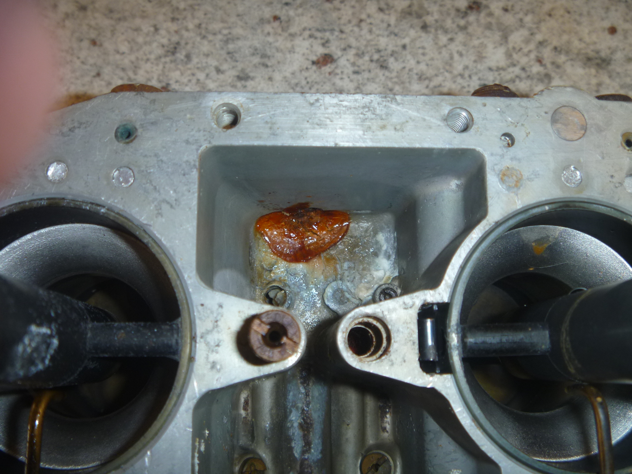

Water in IMO is about the worst thing that can get into a carb cast alloy and brass suffer badly, ask me how I know ? ,had my RH carb apart to sort an unrelated issue and had the top cover off, covered it but that leaked and got water in one of the bowls !!!!!! my fault (IMG:style_emoticons/default/headbang.gif) (IMG:style_emoticons/default/headbang.gif) .
My carbs aren't IDF but water will do the same damage regardless.
I think the water has got further into your idle curcuit ,I reckon you need to give them a very good cleaning ,a bad main jet wouldn't be the cause of a no idle situation ,good luck.
