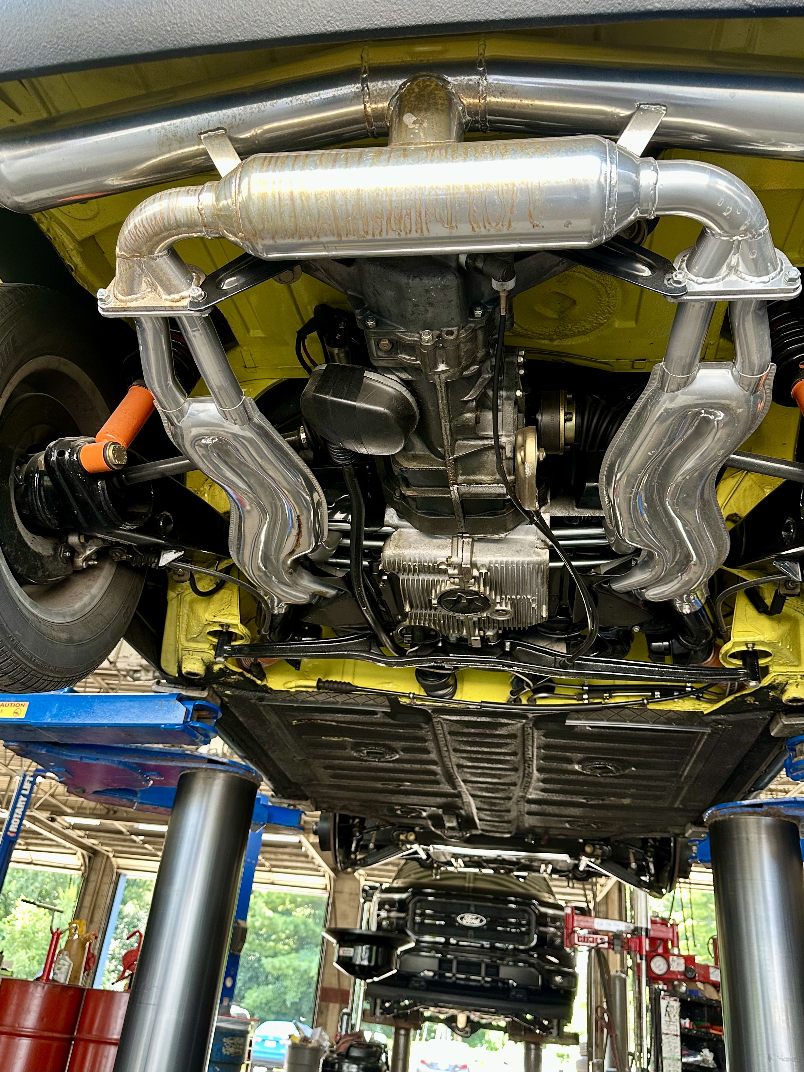

My old (205-60-15) tires looked perfect with about 2K miles when installed about 20+ years ago.
Yesterday I installed (4) new 195-65-15 tires that improved ride quality with improved handling (IMG:style_emoticons/default/pray.gif) This was long overdue and cheap life insurance due to old tire safety driving issues.
Had a great time looking at the 914 on the auto rack to view & take photos of (20-year) old dust & grime on my 2k driven miles. I know (IMG:style_emoticons/default/headbang.gif) (IMG:style_emoticons/default/chair.gif)
Here is a cheap idea for new 914ers taking off and replace hub caps with no damages, 2" PVC tubes for less than $10 bucks at Home Depot (photos) that fit hub caps perfectly.

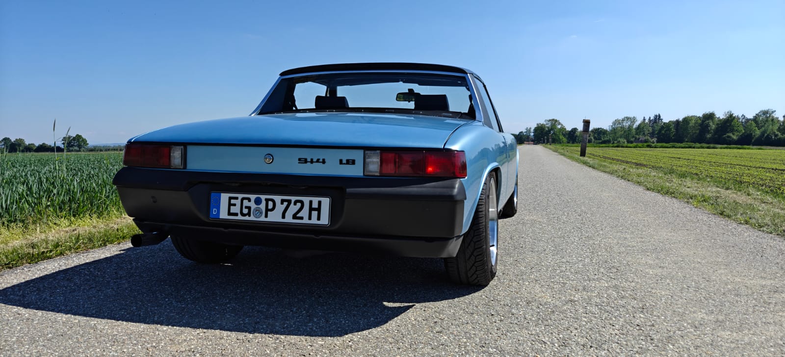

Hey guys,
I do have 205/60R15 Kleber Dynaxer HP4 tyres on 7" wheels with 16 offset.
No need to do some bodywork with this setup.
Third picture is with the 205s on serial rims.
Best regards
Chris
