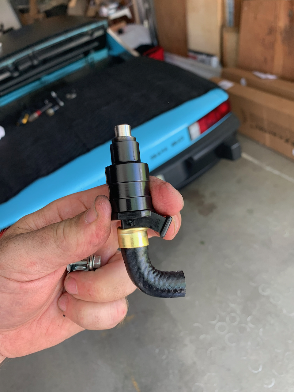

Looks like they've gone up since I got mine in 2021 - I paid 65.89/each (plus the seals) and now they go for 84.79? wow.
Mine look like this - as per the info on Rock Auto:

Those are the old ones... and I still have 2 of those in the car. One had a cut hose from when the clamped it... and another started leaking after about a year. The new clamps I think are better.... but only time will tell. You get a 5 year warranty with these... and you have to return them back where you bought them.

Interesting - mine are (apparently) the previous model, although I've had no issue.
https://www.rockauto.com/en/moreinfo.php?pk...224&jsn=330

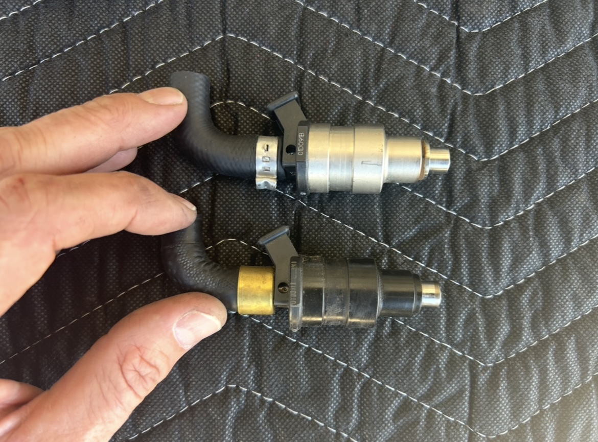

What you’re showing here in this pic were the SMP FJ67 version that the PO installed on my car. Here’s a pic of one compared to the newer versions of SMP FJ67s. Not the body is now silver metal (not black plastic). Also note the brass crimp has been replaced with a clamp. These improvements likely contributed to them becoming more expensive (on top of the crazy inflation in the last few years).
FlacaProductions
post Oct 31 2025, 02:51 PM
Posts: 2,074
Joined: 24-November 17
From: LA
Member No.: 21,628
Very interesting - thanks for this.
I haven't had any issues with the previous/old version - hopefully that continues!

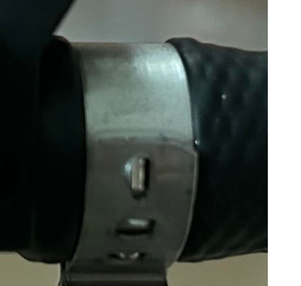

Maybe it's just me, but I don't like how it looks like the edge of the clamp is cutting into the hose. I'd prefer to see a more rounded edge on the edge of the band.

That’s similar to the issue I had with the old clamp. When I inspected the new ones a got the clamp/hose combination looked good. These are all done on a machine and it seems they are having manufacturing variances. Best to inspect and return the defective units. When it leaks…it can get out of control in a hurry.
