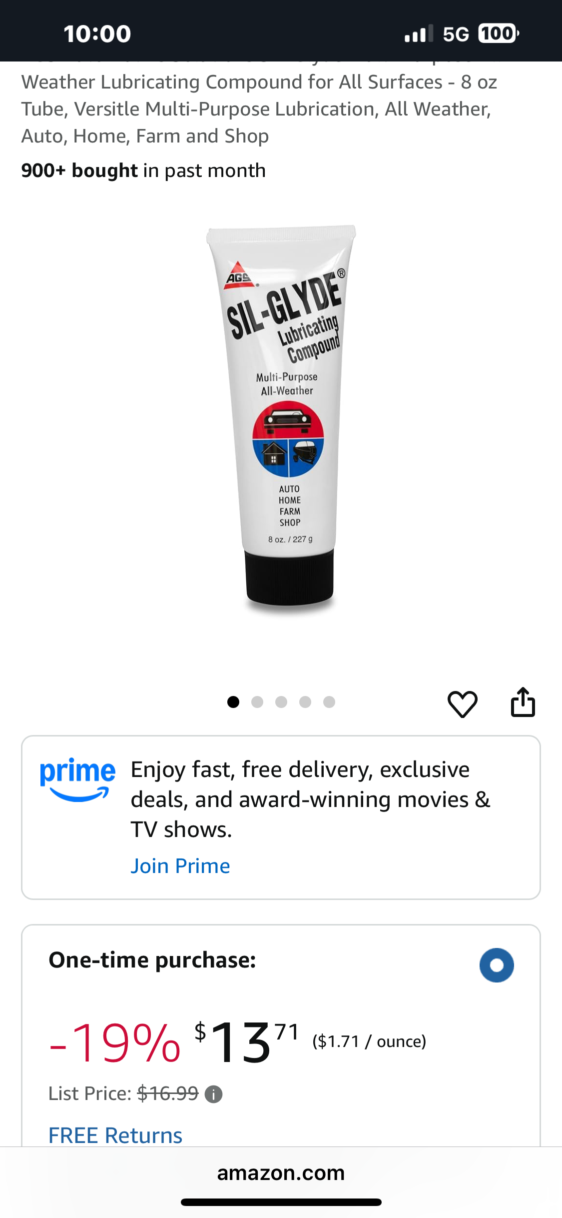

Sil-Glyde

Looking that up.

2nd for Sil-Glide That stuff is the best! NAPA sell a house brand that is the same for 1/3 the price too.
Dyno
