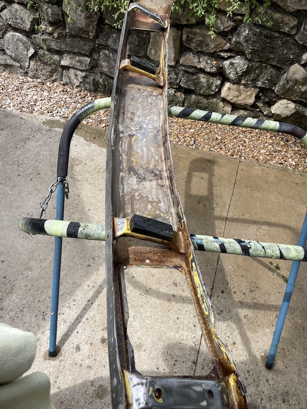

The first one is almost dumb, OK, dumb. On the 1973 and 1974 front bumper. These blocks are located behind the front tits. Which way does the fat part of the rubber block set, up or down? I believe I have been installing them fat up but I don't remember if I researched it or assumed?
No clue if these were ever messed with but I just pulled out my bumper this past weekend to be restored. Looks like fat part "up".

QUOTE(friethmiller @ Aug 19 2025, 02:24 PM) *
QUOTE(914ltd @ Aug 19 2025, 03:52 PM) *
OK, Thanks for the reply. Brad

And I never noticed they had a taper. Learned something new after decades of taking cars apart.

Thinking the difference in pad caused by years of being compressed from being mounted.
