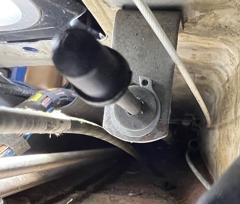

QUOTE(ctc911ctc @ Aug 20 2025, 05:46 PM) *
Any advice as to this process? Asking those that have done this wrong in the past (IMG:style_emoticons/default/dry.gif)
If you have budget for a borescope, it will be very helpful. One with a light on the end and the ability to display live video as well as take photos in particular. They start at $50 and you will use it more than you think. Some more expensive ones have both front and side-view cameras.
Here is a shot from the gas pedal looking rewards in the tunnel of our 1970 914-6.
