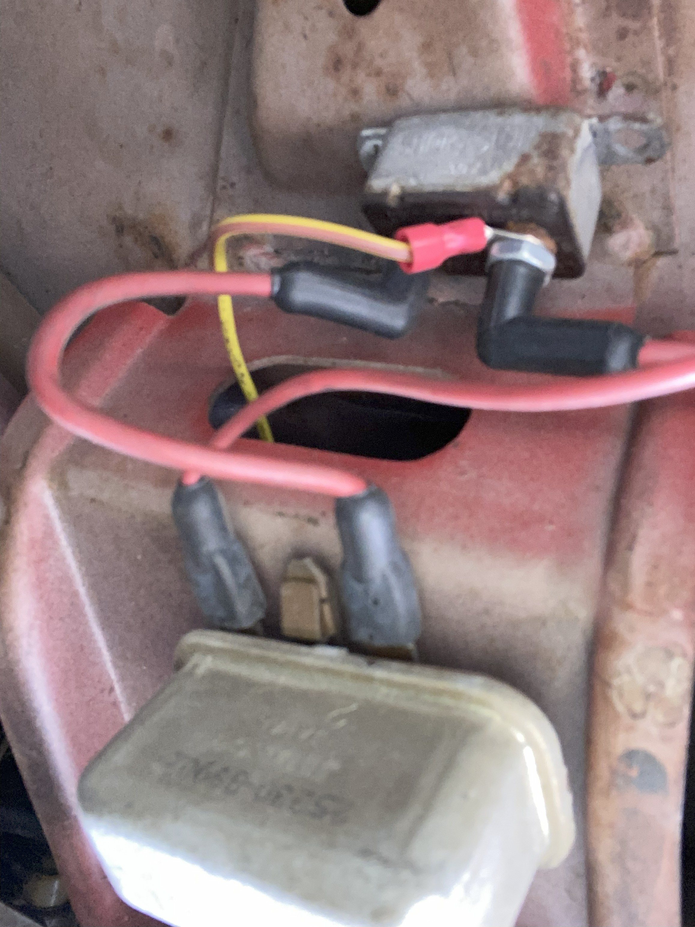

Can anyone ID each of these relays?
I used the search and google and cant find any similar diagrams..
Thank you

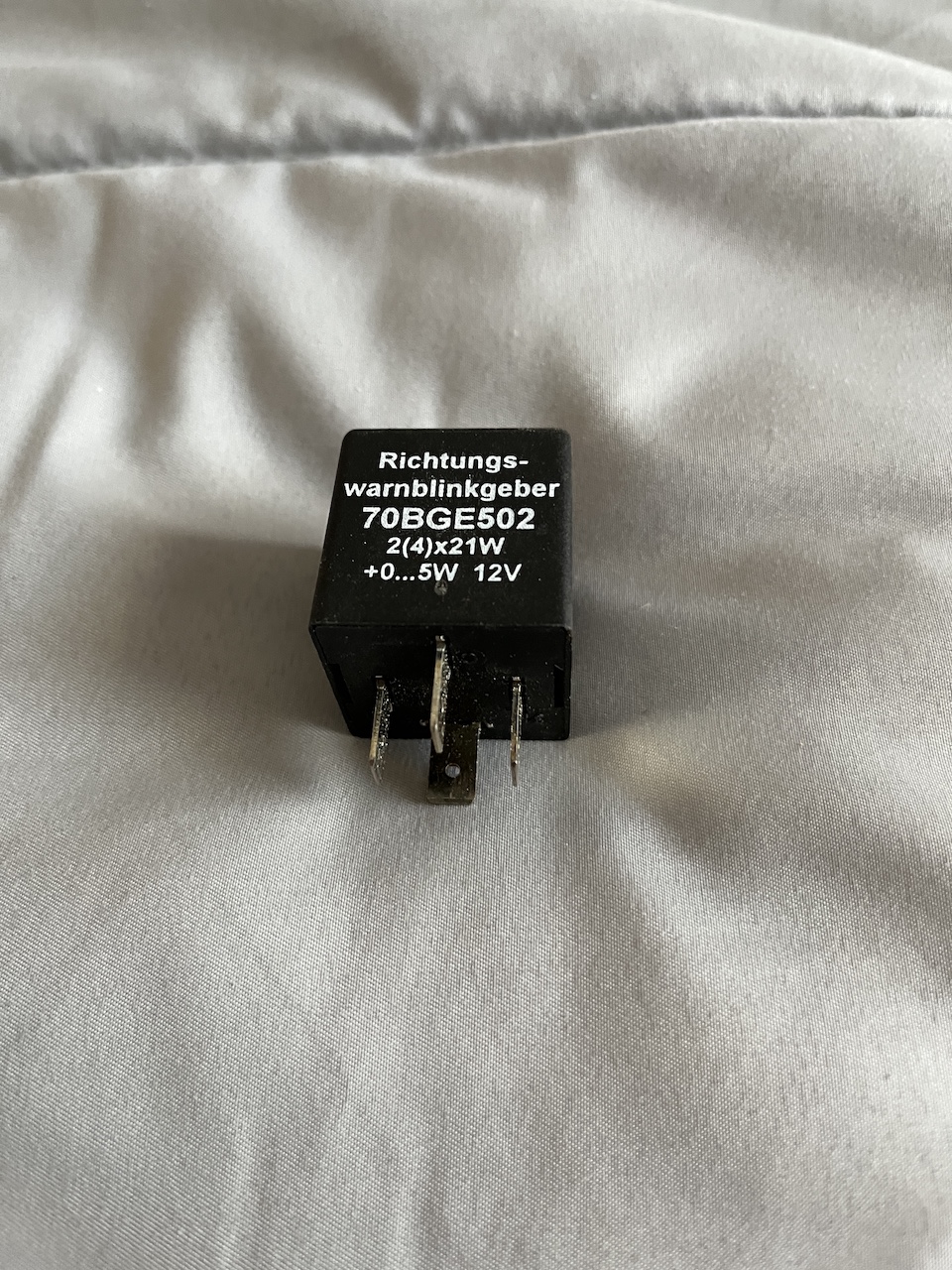

Turn signal post is mounted in dash frame NOT on fuse block board for 70-71. Round are multi purpose and square is head light relay. Turn signal relay is SQUARE with FOUR blades. Picture is late model solid state

yours is up on the dash shelf inbetween the switches

could the turn signal relay be one of these I found under the dash?
