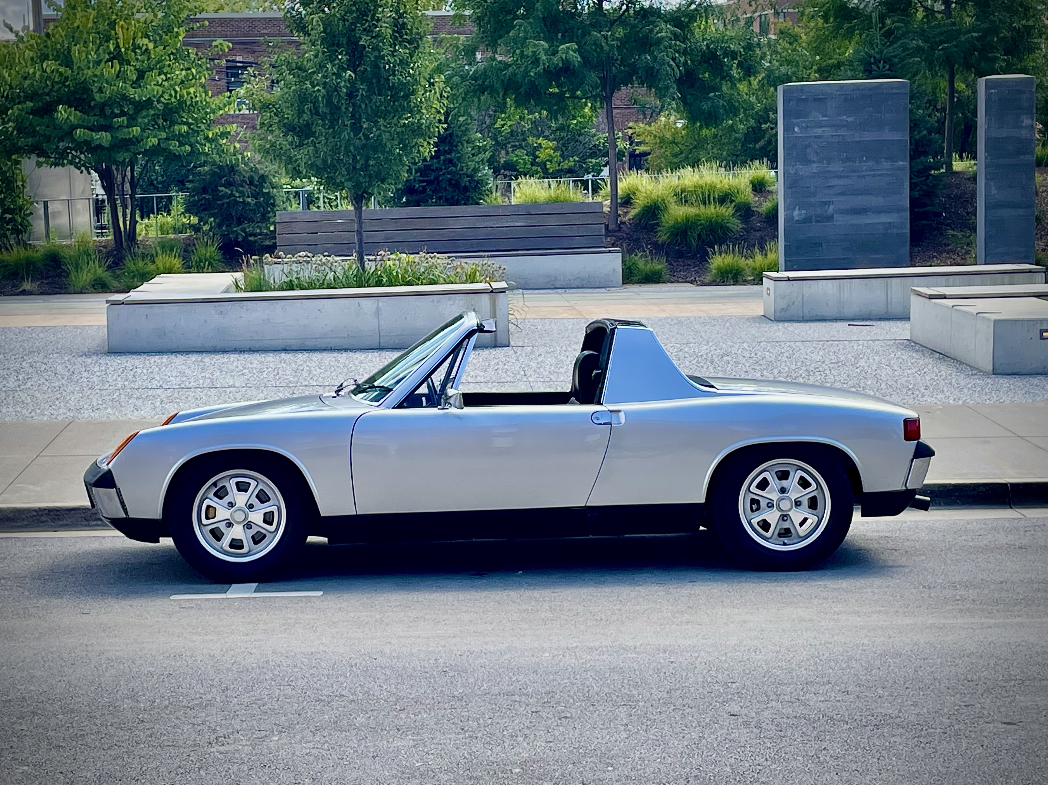

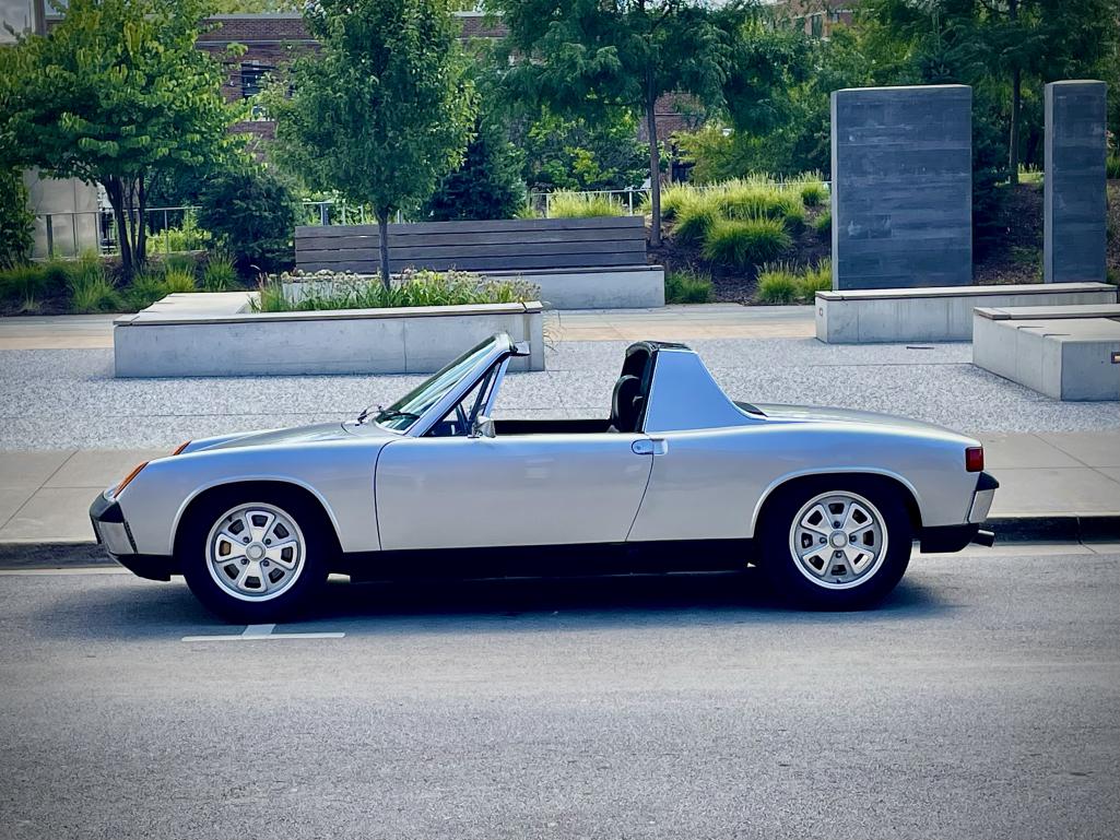

My 205x65x15"s work fine on original 5.5" steel rims. (IMG:style_emoticons/default/shades.gif)
