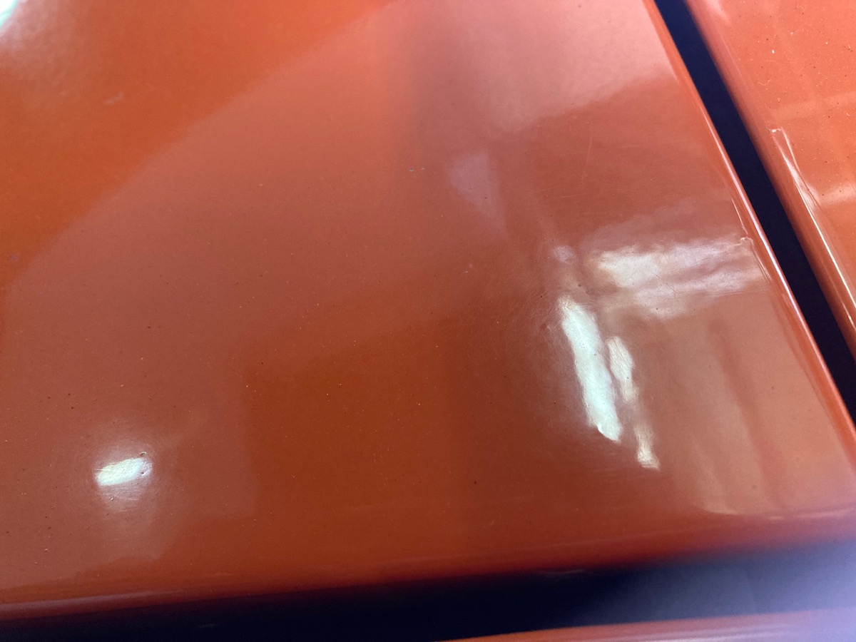

AFAIK our cars were finished with a synthol enamel, probably one tack coat and 2 full coats. I am not interested in going base coat/clear coat and am looking forward to an original or close to the original orange peel. How is this measured (profilometer), what was the original?

QUOTE(930cabman @ Sep 2 2025, 03:23 PM) *
TIA
you are probably right.
and not necessarily glasurit either. i think glasurit may have supplied the porsche factory (or BASF whoever made it) but i don't know that for sure. also it was karmann painting the cars not porsche (rueter).
solvent based. a member here with a 74 saturn yellow was going through this a couple of years ago. he has been off the radar for a while but there was a topic on it.
the enamel glasurit (solvent based) he found impossible to get i believe in the USA.
at least officially. and i'm not sure about his luck in looking for other versions that might have been non solvent based.
i don't know enough about paint to know more. one thing i have heard is that painters down here trying to get results in top end restos of 60s/70s aus muscle cars usually use an additive to knock the gloss levels back to match the appearance of that vintage paint. would not know how you get the orange peel but it can be done. its all in the hands of the painter.
good luck. you need to consult a master painter to work out how you could accurately achieve a restoration finish that gets around modern enviro friendly paints.

Trying to get close to the original look, not interested in a "mirror finish"

I found this locally in Palma Green: https://techinfo.glasurit.com/en_US/22-Line...-Mix)_en_US.pdf
Getting close with the block, might get to color next week. I will have several samples

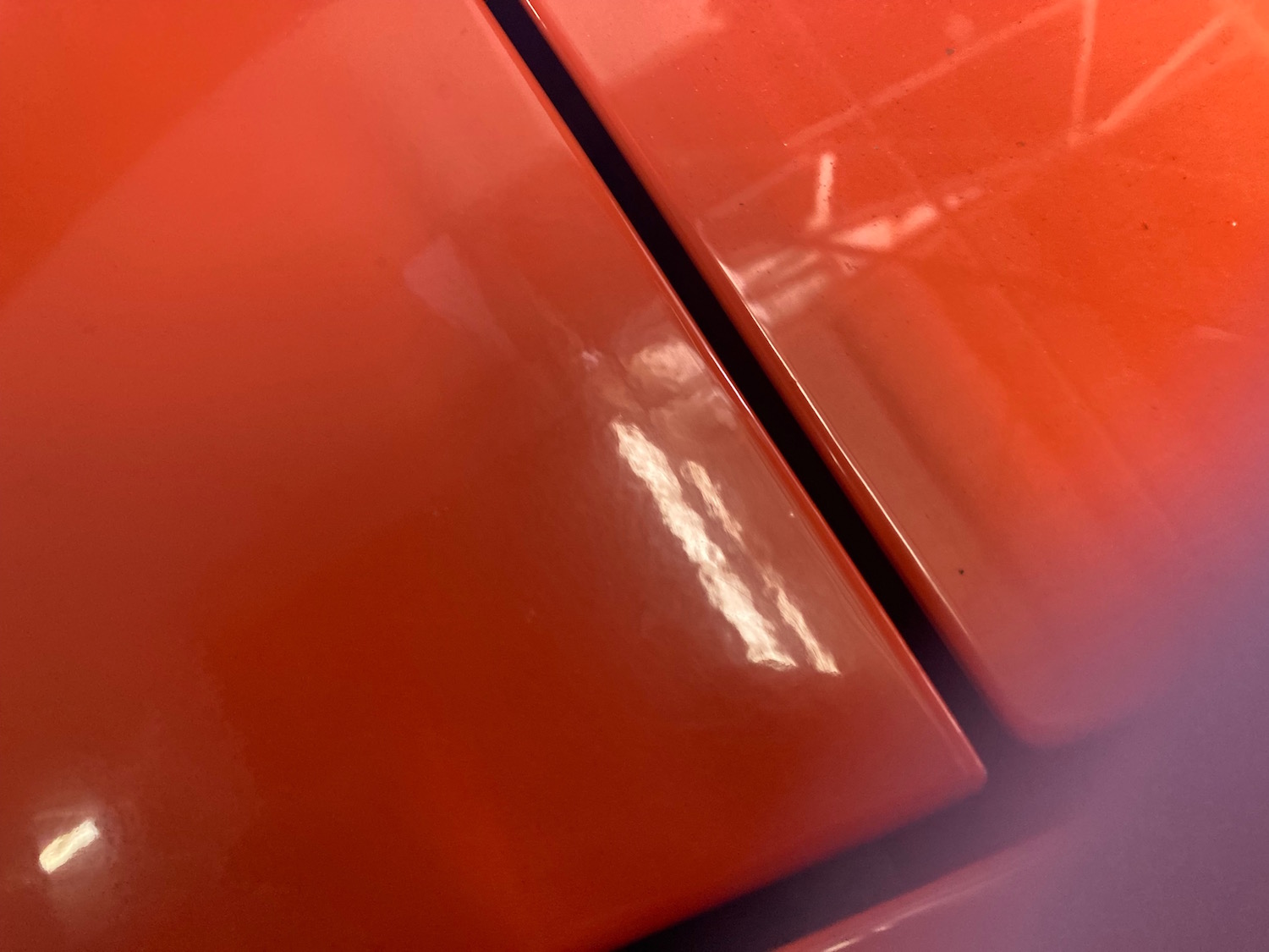

I found this locally https://techinfo.glasurit.com/en_US/22-Line...-Mix)_en_US.pdf It's their 22 line urethane acrylic
and have tried a few samples, seems to shoot well. I am still blocking and will hopefully get more into it next week
question is how much orange peel? It's a small amount for sure.

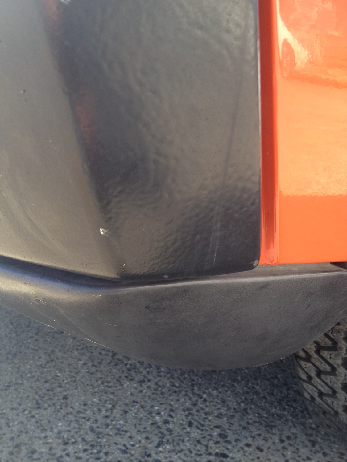

can try and take a photo of mine on the weekend if the sun is out.
the paint on the flanks and inners is still pretty much ok and factory.
right sort of light will pick up the dimples. its small.
the bumpers valences and rockers are a lot more orange peel.
pretty sure thats actually black paint over shutz which leads to that particular orange peel.

At the end of the day, it’s not about the paint type and whether or not it’s baked. Surface finish is a function of so many variables (temperature, how the paint is thinned, etc., and most of all how it is applied). Trying to shoot for a particular level of orange peel is going to be quite a challenge.
I’ll just share one last bit of experience - once you begin to wet sand orange peel - you’re almost fully committed to ending with a smooth finish.
When you knock just the tips off orange peel, but leave the “valleys”, it looks horrendous in my opinion. At that point it doesn’t look properly painted, nor does it look properly finished out.

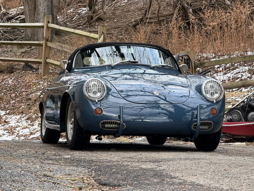

Our painter gets single stage made up in any color we need. I’ve never heard of it being unavailable, just not used for modern cars.
This is aquamarine in single stage. He’s done a half dozen other cars for us since then. All single stage.

I am currently blocking everything and will try a few samples this weekend. Perfection is far from my MO, a decent finish with some orange peel, not too many waves and shiny is the goal
a mirror finish is not the goal

QUOTE(930cabman @ Sep 5 2025, 04:56 AM) *
QUOTE(wonkipop @ Sep 4 2025, 05:46 PM) *
QUOTE(930cabman @ Sep 4 2025, 05:38 PM) *
Supposing I was a nut, I could source one of these: https://www.keyence.com/products/3d-measure...asure/vk-x3000/
But I'm not that crazy.
who cares if you are a nut. not me. bet i am crazier. (IMG:style_emoticons/default/biggrin.gif) (IMG:style_emoticons/default/beerchug.gif)
to assist. 74 p rot. factory finish (apart from wear over 50 years to account for).
ive not polished it since 91. just clay bared it in 20.
my 2002 renault clio RS is more orange peeled.
the french robots were even drunker than the beer drinking hoons at karmann after lunch?
Yes, that's the look and there is a fair amount of latitude, assuming one's level of spirits
go for it.
the surface of an orange is beautiful. (IMG:style_emoticons/default/beerchug.gif) (IMG:style_emoticons/default/biggrin.gif)
