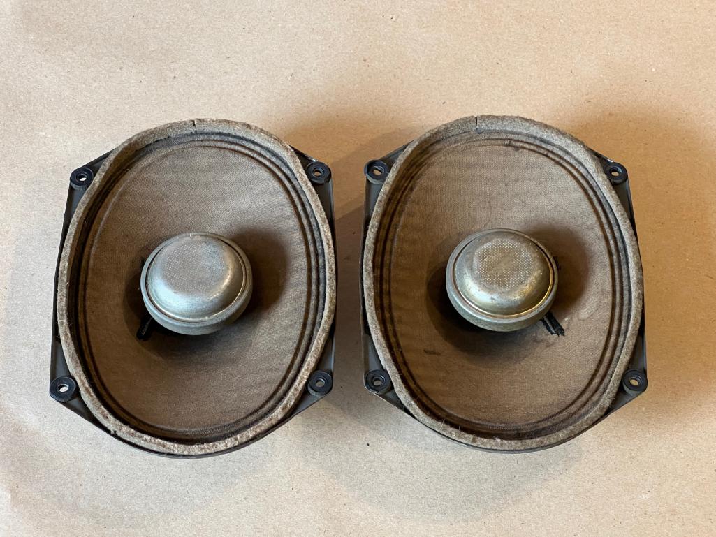

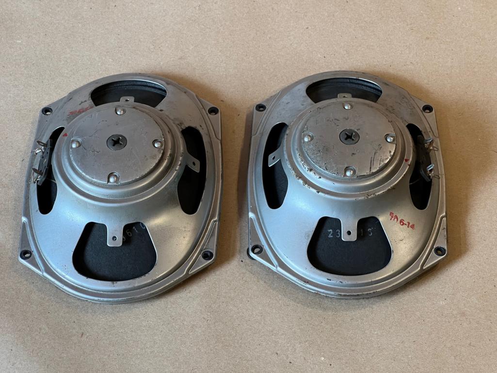

The ones I took out of my '74 914/4 looked like below. No idea if they are original or not. No brand or other manufacturing indication visible.
Btw, there are a couple of threads on installing modern 4 x 6 speakers in the existing housings. I have JBL 6422F’s installed with a Pioneer subwoofer hiding in the center console.

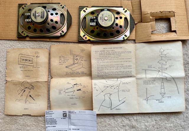

Stoddard years ago sold the kits ,,NOS ,,
Here is an eBay listing with pics.
https://www.ebay.com/itm/116610791050

Member No.: 15,610
That’s a great link and find. For plug and play not a terrible price I guess

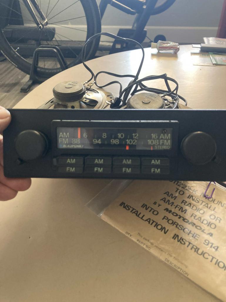

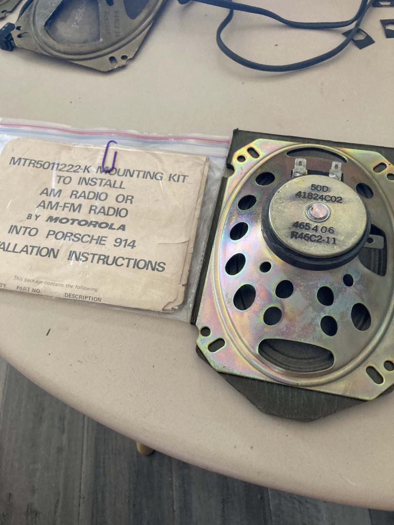

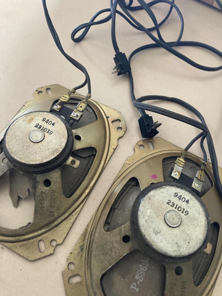

These are the speakers I purchased from Tom earlier this year , They are Motorola .
Here are the original speakers and wiring that came out of my 1976 914-4 No brand name on them .

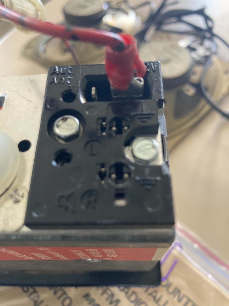

I also purchased this year an original Blaupunkt AM/FM radio. Notice the speaker connections . These are different from other radios I have installed . Good thing I never throw anything away and I still have the original wiring and connectors .
.Attached Image
My understanding is most radios were installed at the dealers so they may be many different manufacturers of the speakers installed .

FACTORY INSTALLED radios came with Blaupunkt speaker. Anything else is up for grabs because of dealer installations.
2nd set of pictures is Blaupunkt even though they are unmarked.
