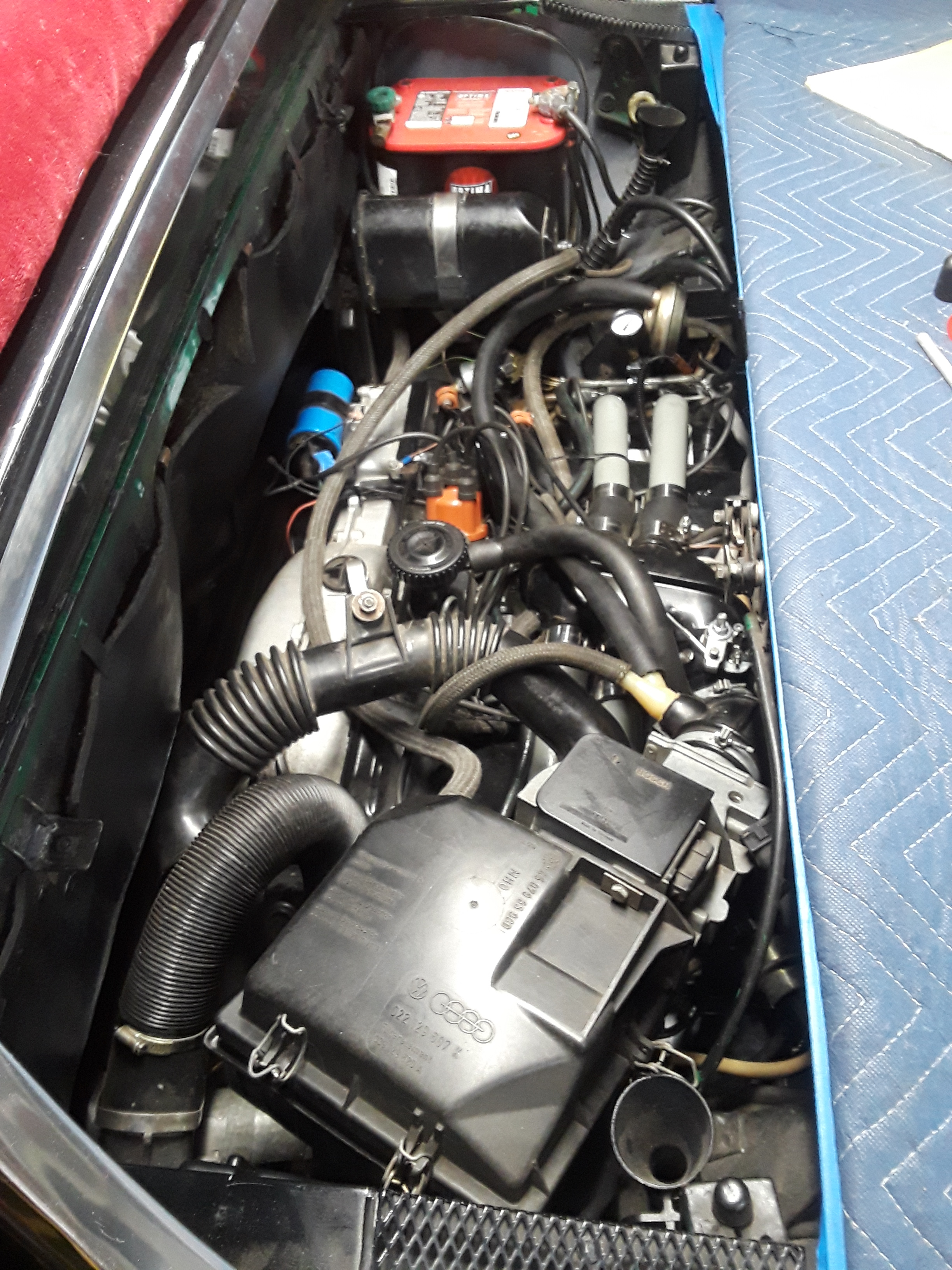

How are people fitting the Ljet intake manifolds to work with 2.0L heads? FWIW this will be on my 2056.

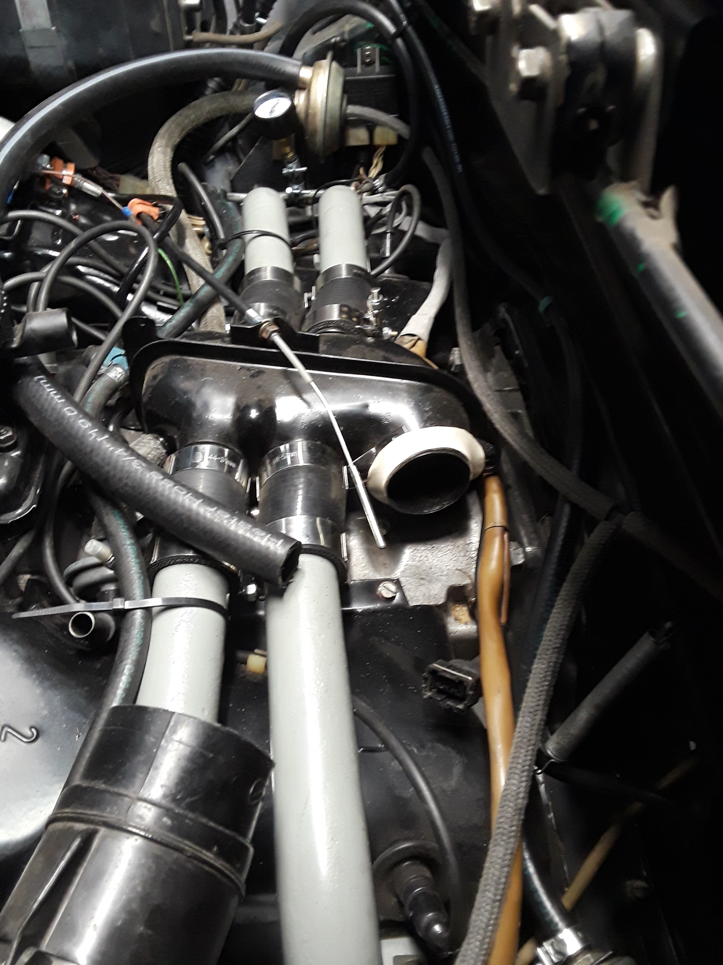

I used custom silicone connector hoses

So you use the Djet runners on a Ljet plenum? SO it fits the head pattern ?
QUOTE(914werke @ Sep 20 2025, 12:41 PM) *

You'd have to use the 2-liter runners. They're shorter than the 1.8 ones, so you need longer hoses to connect to the intake air distributor. (AKA the "plenum".) The runner pipes are the same diameter, or close enough.

Take the 1.8 runners and drill 3rd center hole. You should be able to bolt on 2.0 spacer block on and use it as a pattern for hole.

Seriously though if you have 3 bolt heads and 4 bolt runners you will have to modify your 1.8 l-jet runners or swap your heads. If I recall the 2.0 runners are going to come up short and in the wrong position to work properly with the 1.8 plenum. You could probably adapt them with soft hose or physically modify them but I suspect using modified 1.8 runners would be a cleaner setup. 1.8 and 2.0 runners are the same ID so you are not losing anything.

The other 2 holes will also need to be enlarged as they are in slightly different locations.

So you use the (2.0L) D-jet runners on a Ljet plenum? SO it fits the head pattern ?
(IMG:style_emoticons/default/aktion035.gif) for good measure I used SS tight seal bolt clamps as well.

In my case it was a 2056 that I fitted a GoWesty TB L-jet kit to & also applied the intake air mod proven and documented by Deming oh so long ago.

I have run L-Jet on a 2.0 engine. The runners are shorter, and you need longer hoses. That's it. It will bolt on and run.
