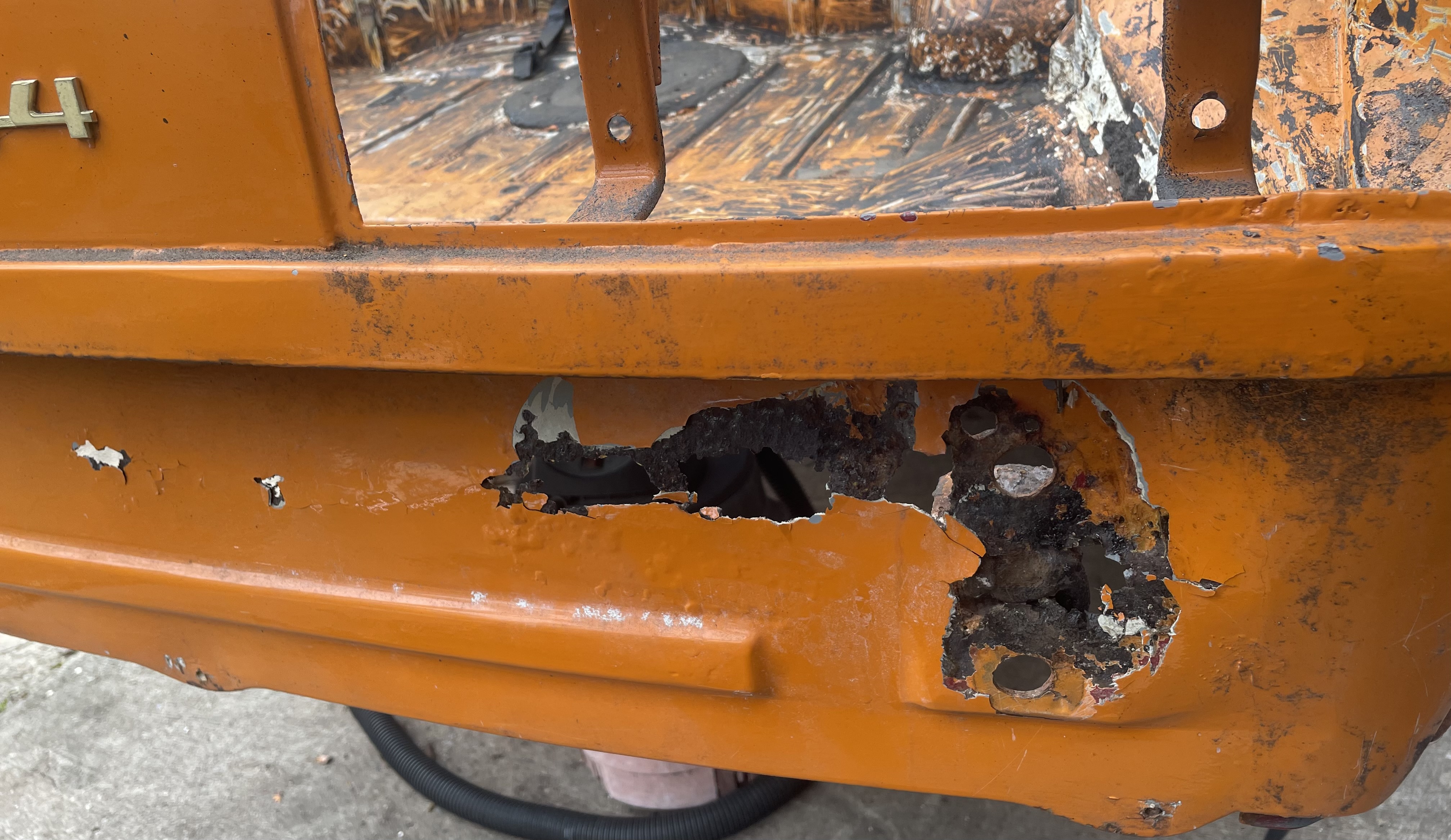

The floors were Swiss cheese (see the before pics) worse than I’ve seen on a car that I’d consider a good rebuild candidate tbh. PO used bondo to fill the holes, I kid you not. The back part of the rear trunk was terrible - had been patched with fiberglass cloth that water had gotten under. Then everything covered in a bedliner product that was only sticking in about 80% of it’s coverage, including wheel wells.

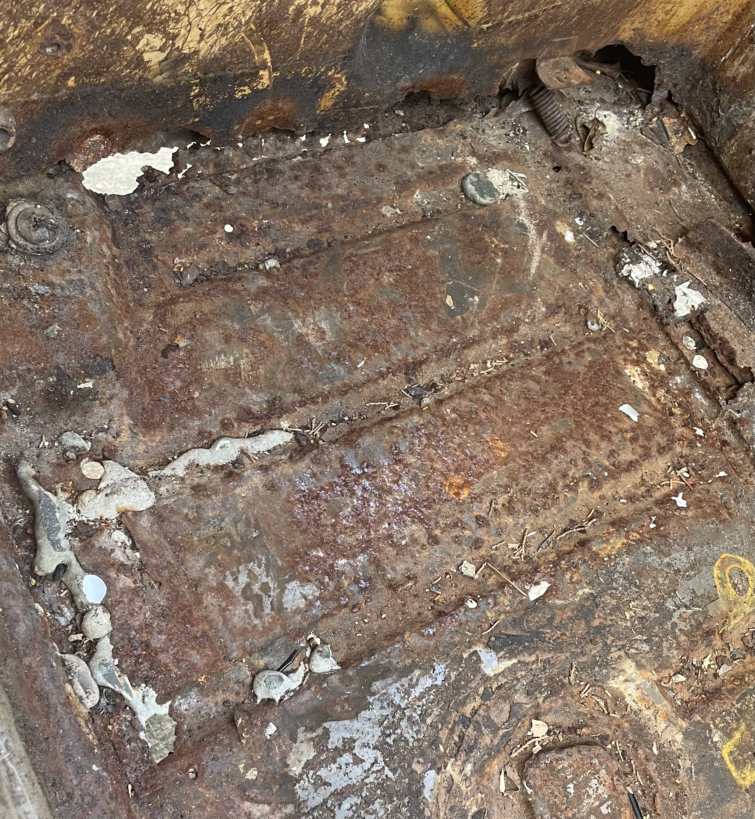

The floors make me wanna (IMG:style_emoticons/default/barf.gif)

Bondo:

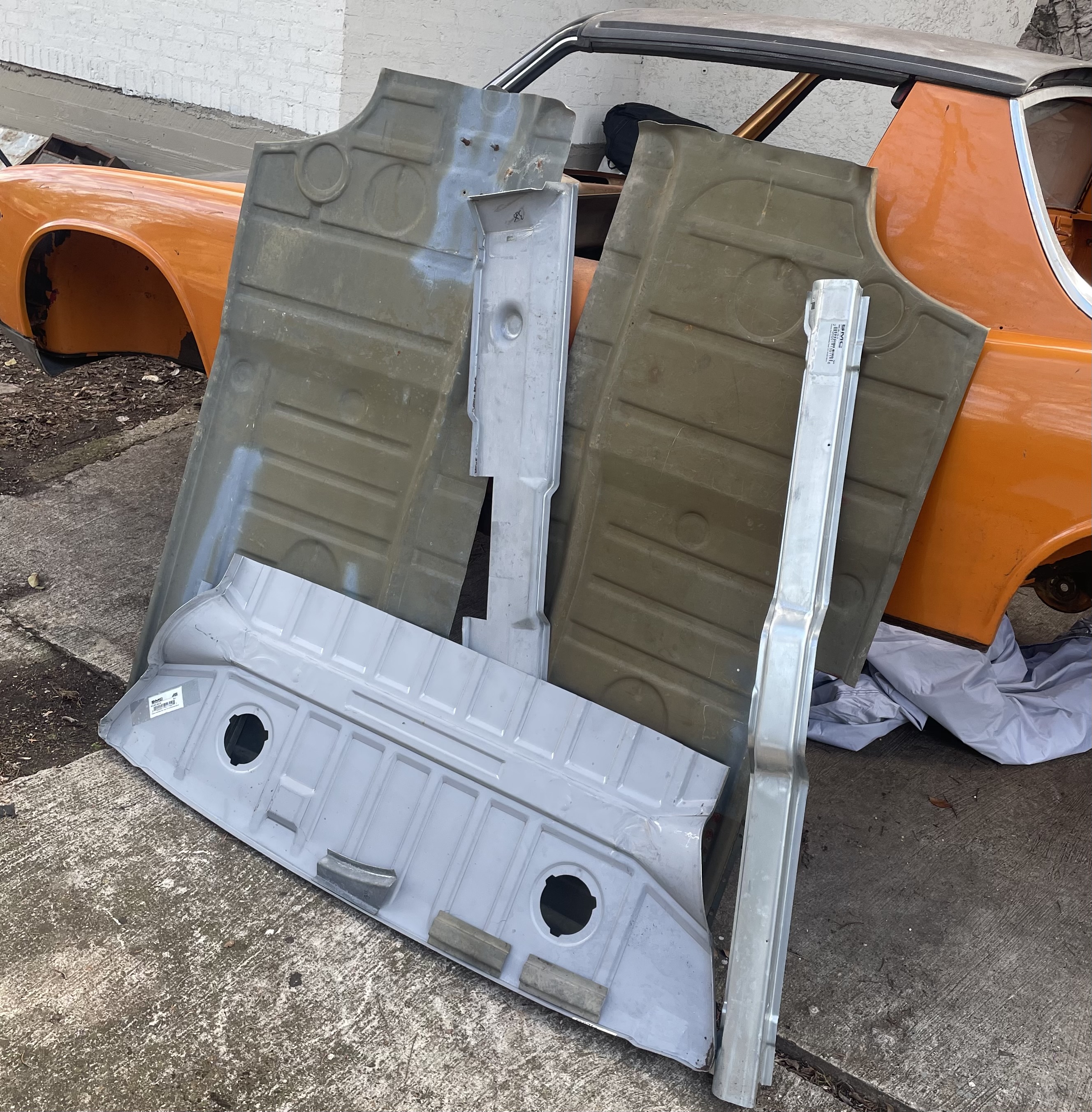

Replacement parts:

The fiberglass cloth used on the back edge of the trunk floor apparently trapped water enough to create some rust thru areas. This will be repaired before the new trunk floor goes in:
