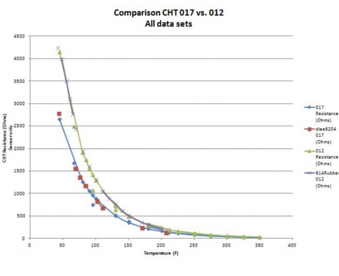

CHT problems - your description of how you verified it is too vague. Which CHT do you have 012 or 017? I’ll post the full calibration curves for each across the whole temp range.

Superhawk996
post Feb 16 2026, 11:48 PM
Posts: 7,685
Joined: 25-August 18
From: Woods of N. Idaho
Member No.: 22,428
914sgofast2
