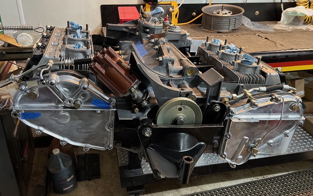

I am trying to gather the parts needed to install a 2.4S engine into my 914 restoration project. I have seen the various mounts that need to be welded to the firewall, but i'm yet to see a picture of the item that is fixed to the 911 engine. Does anyone have a picture or a link to a thread that might educate me further.? I assume the 911 item i removed from the case is 911 specific.?

Luke gave you some great examples. The piece needed comes with any bulkhead mount that you purchase and looks very similar to a 911 engine mount.

This is mine Dave, bolted and welded to fire wall. And bolts onto front of engine. MarkAttached Image Attached Image
