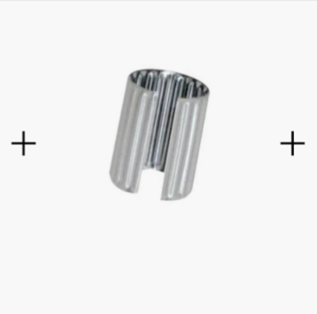

However... A loose bushing on the column will cause the horn issue. I had that problem last fall. In my case the little cheater sleeve that goes between the bearing and the column had slid up and just needed to be pushed back down. You can see this by removing the steering wheel and just look down the column.
