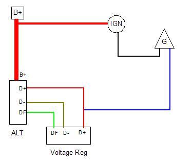

This diagram is of the charging system. Pretty simple. One thing that is required is the G lamp. If this is left out, the alternator will not work.
Note the thickness of the lines indicates (roughly) the wire gauge required. The gauge from the battery to the alternator itself has to be quite hefty (3 or 4 gauge). Up to 55amps of current flows through this wire, and 20+ amps is a pretty common level of current here.

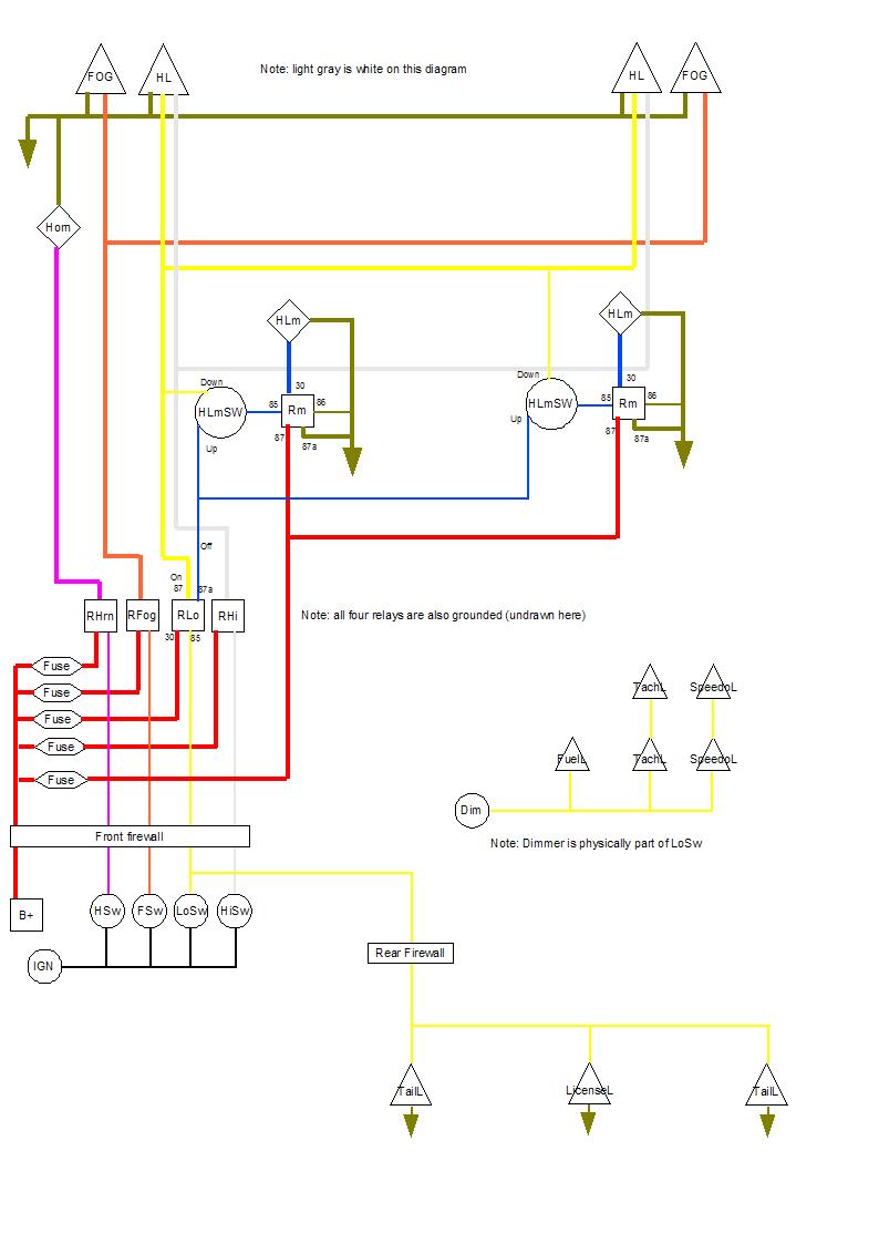

Here's a general lighting diagram. I'm not including turn signals, which will be a separate diagram.
I'll be putting some detail on how to use relays in a later post. The idea on this diagram is to put the relays for the front-mounted lights and horn in the front trunk, since that shortens the wiring runs for large-gauge wires. It's also assumed the stock headlight switch is used, as it's a very nice switch, even if it has 8 zillion terminals on it. If your switch is dead or missing, you can get a replacement at a Bug shop that has only 6 terminals on it, and costs only 10% as much as the 914 switch ($30 v $300, no kidding).
No parking lights are included here, so this arrangement wouldn't make the German authorities happy, but it would get past the US authorities. Adding "side lights" (turn and side marker lights) could be easily wired in to the low-beam circuits, so they'd come on if the regular lights are on.
For high beams, one could use the first position on the stock switch as low beams, and the second position as high beams, and wire it all up as shown here. I may put together a variation including the stock system of using the momentary switch on the stalk and the stock latching relay. This same system is used on many VWs, so the column switch and the relay are readily available cheaply.
Finally, this circuit will allow fog lights to be turned on any time the car is running, not just when the low beams are on. This is a commonly asked for "upgrade", and it's simple to do. To make the fogs work as stock, just replace the black power in wire at the fog switch with another yellow low-beams wire, powering the switch from the low-beams signal.
In the diagram, HLmSW is the "wiper" switch in the motor itself. Rm is the motor relay, which is found under that plastic cover near the motor in the stock setup. It's a standard 5-terminal relay, and the small numbers are the post numbers on the relay itself. A standard "square" 5-terminal relay could be substituted here, if your round relays are missing or dead.
I've not numbered the other relay terminals, because they're "standard", in that 85 is the switch power, 30 is power in, 87 is power out, and 86 is grounded. 87a isn't used (if you use 5-terminal relays), except on the low beam circuit, as part of the motor circuit.
I want to thank Clay Perrine for his headlight motor circuit diagram (in the Classic threads section), as it saved me the trouble of working out how the bloody thing worked by squinting at the wiring diagrams.
