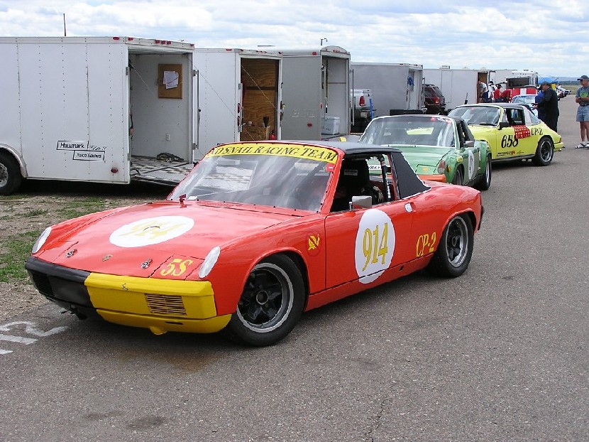

Here is the exterior:

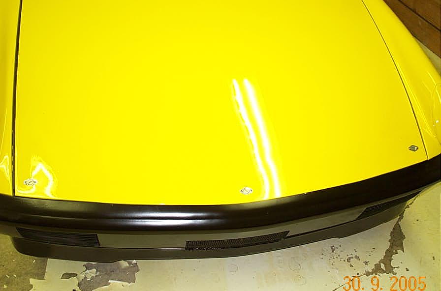

I have pins in the rear....at the front only, and dzuts on the front hood
J P Stein
post Sep 30 2005, 01:29 PM
Irrelevant old fart
Posts: 8,797
From: Vancouver, WA
Member No.: 45
front...5 of these rubys total.

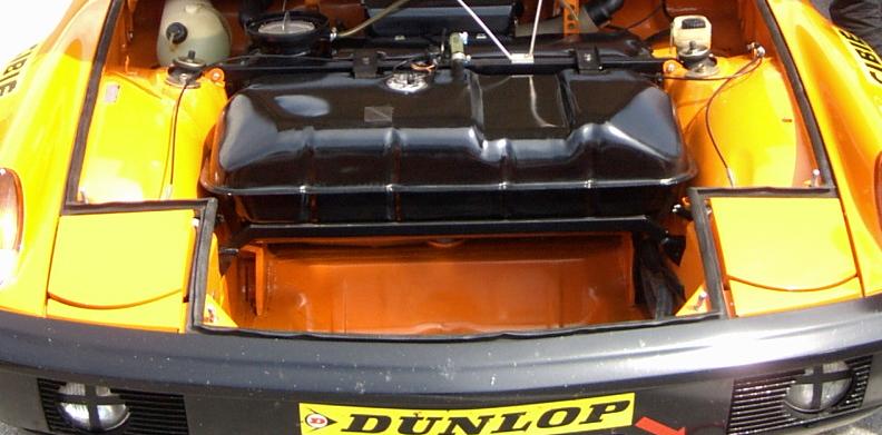

I've none of theese on my teener, but the pic shows factory originals

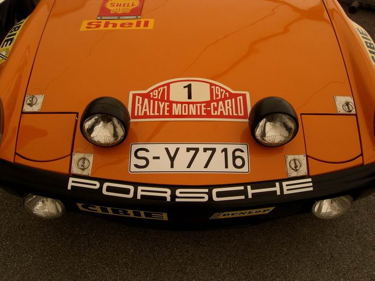

other car, but factory original, too

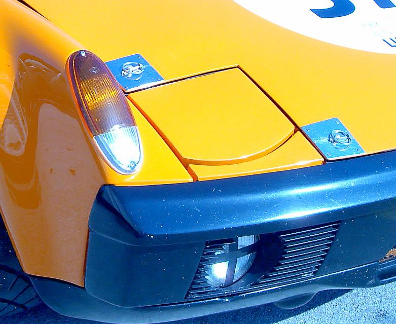

same car, closer view

brant
post Sep 30 2005, 04:05 PM
Posts: 12,005
From: Colorado
Member No.: 47
We went with only 2 pins instead of 4 pins due to weight.
thats why my car doesn't have the front pins in the normal "corner" area. We decided to use the normal corner area, you really would need to have 4 pins.
but.... since we were only going to have 2 pins, then frontal air sneaking under the front lip would be the most important area to have pinned.
thus we went with the non-traditional location.

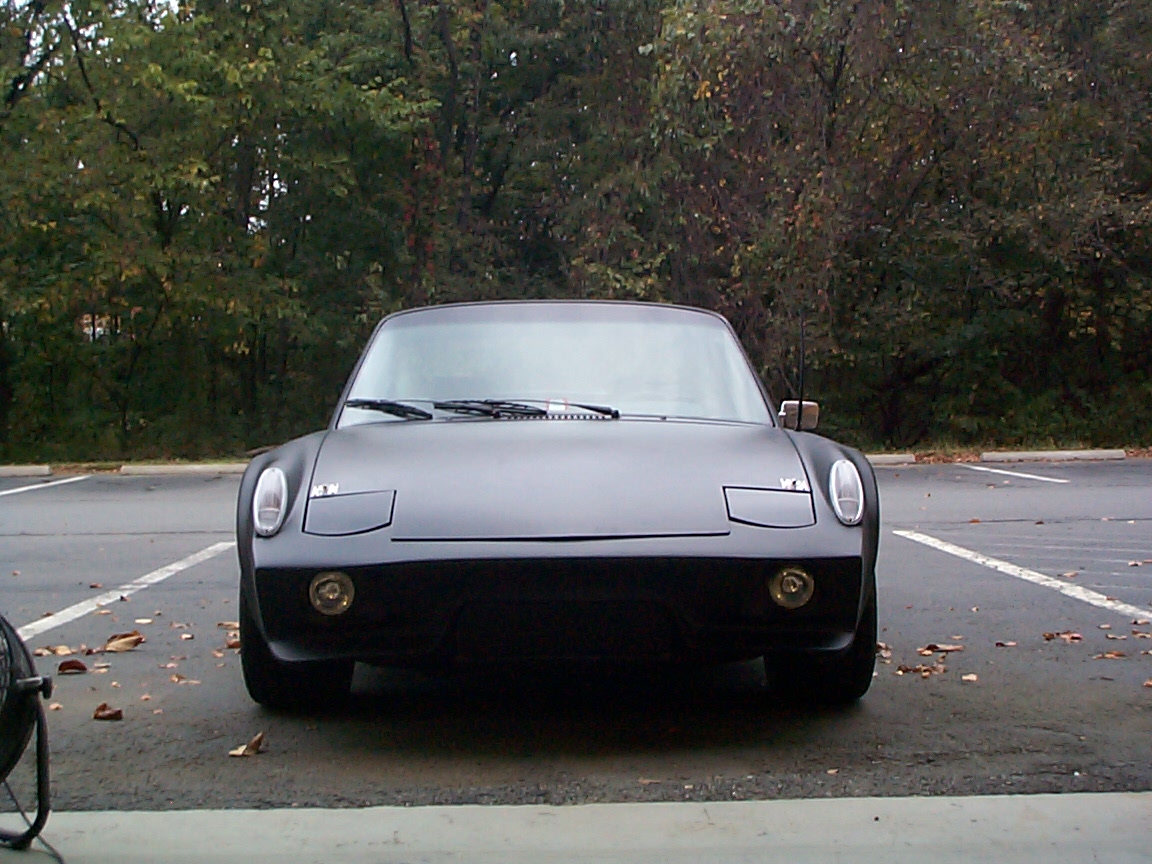

Kerry- Just saw your post on pins.
Here's a shot of the 'stealth 914' directly from the front.
With the pins above the lights and front trunk seal installed..
I got this pucker in the middle and the whole front
edge is slightly up (1/8"-3/16") (IMG:http://www.914world.com/bbs2/html/emoticons/headbang.gif)
So I made another set of square S.S. scratch plates to put
them in the bottom corners too! Otherwise I'll need to do some
Bending and Banging! (IMG:http://www.914world.com/bbs2/html/emoticons/smash.gif) to make it fit right.
