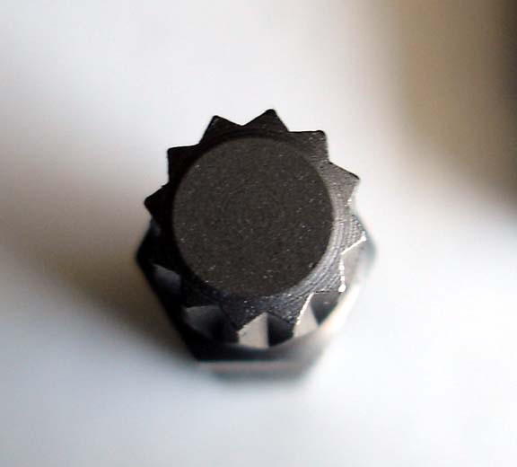

This is the end of the triple square

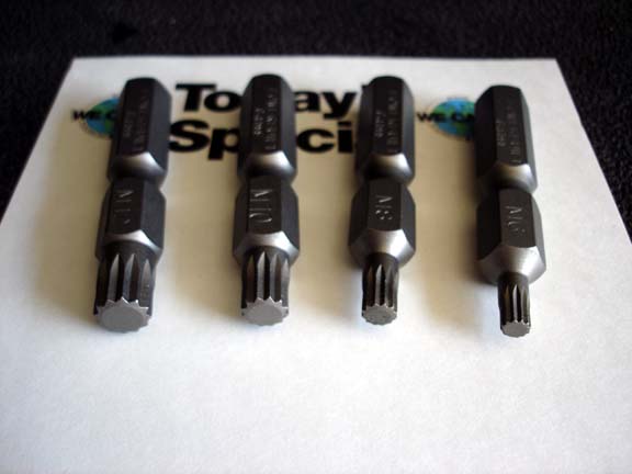

I found this set of triple squares at Kragen for $18. Their base is 13mm so you can get either a wrench or socket on them depending on clearances. I have also heard that they are called RIBE bolts, tho I have no idea what that stands for.
I have found them in a couple of different places. Some brake calipers heve them, some CV joints, the squirrel cage fan bolts, and we were pulling a bus motor apart not to long ago and the flywheel bolts had the 12mm size. Weird.
Many people destroy a lot of these bolts trying to remove them with torx head sockets and then replace them with standard metric allen head bolts.
