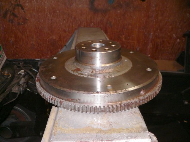

Stock flywheel
TonyAKAVW

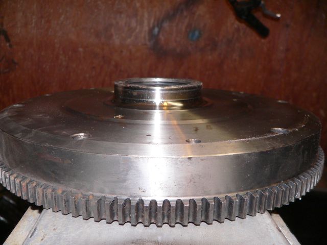

KEP flywheel
TonyAKAVW
post Oct 4 2005, 11:35 PM
That's my ride.
Posts: 2,151
Joined: 17-January 03
From: Redondo Beach, CA
Member No.: 166
Looks like the spacing is just under 1.4 inches from the flywheel to the top of the mounting spacer thing.
I forgot to measure the thickness of the adapter plate. Dangit.

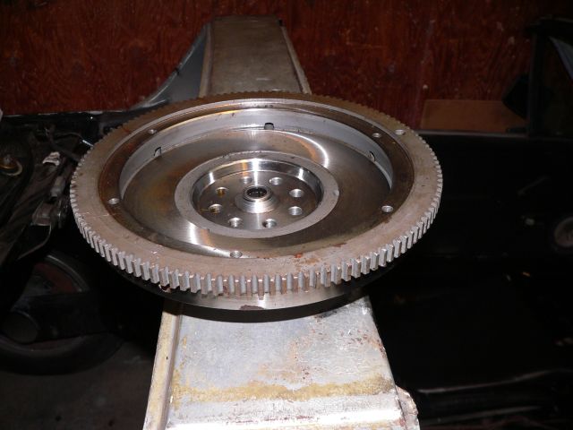

Anyway, here's the other side of the flywheel
