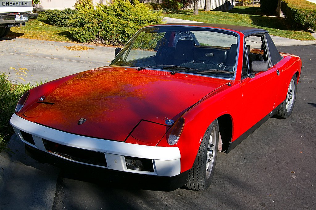

OK, here it is. Proof positive that my 914 conversion really does run. Look!!! It is somewhere other than my house, or on jackstands. This was taken in front of my in-laws house in Boise. Oh yea, that's me. Took the wife out to dinner in it and gave her a minor demo of its power as we were trying to cross Broadway Ave. after leaving the resturant. She was definitely impressed... I could tell by the tone of her yelling at me to "SLOW DOWN!!!" (IMG:http://www.914world.com/bbs2/html/emoticons/driving.gif) (IMG:http://www.914world.com/bbs2/html/emoticons/mueba.gif) (IMG:http://www.914world.com/bbs2/html/emoticons/monkeydance.gif)
dbledsoe
post Oct 24 2005, 03:54 PM
Mutineer
Posts: 300
Joined: 13-May 03
From: Boise, ID.
Member No.: 687
My thoughts (for the winter) of ducting air through the fog light holes to the radiator didn't work. First trial run with the bumper installed had the engine temp approaching 210 degrees within 2 miles of driving in 70 degree weather. That led to a hasty cut (IMG:http://www.914world.com/bbs2/html/emoticons/sawzall-smiley.gif) in the glass bumper, which cured that problem.
