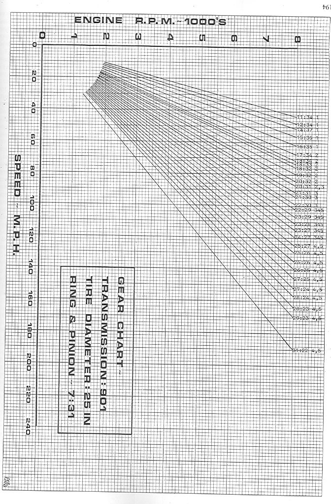

I just bought a '71 3.2 conversion with a 901 transaxle. The gauges are from a 911 of some vintage and the speedometer isn't accurate. With the stock final drive and gear ratios of the 901, what is the gear limited top speed? That info would help me find a correction factor for my speedometer.

I'm running 205/50 series tires as well and at redline in 5th gear the speedo indicates 145 mph. I know this is way high. I'm thinking it's closer to 125 or maybe 130 but I'm not sure. There should be a theoretical gear limited top speed for stock tire size and gear ratios that I could use to plot a curve and fit an equation that would give me my actual speed vs indicated speed. Does anyone know the stock gear ratios and ring and pinion for a '71 901?

the ratios have been documented here many times but here is a listing of all the ratios and all the designations.
enjoy.

Artechnika, thanks, that's exactly what I needed. Krusty, I realize that the gears have nothing to do with the speedo. I'm trying to figure out my actual top speed at redline in 5th. I can take that, along with my indicated speed at the same point and plot them. The error in my indicated speed increases linearly as speed increases. I can plot a curve and fit an equation that will tell me how fast I'm really going at any indicated speed. It's a cheap way to tell my speed until I get around to having the speedo calibrated. Thanks for the replies.

that chart comes from Bruce Anderson's "911 Performance Handbook" which - if you have a 6 - you really should have...
