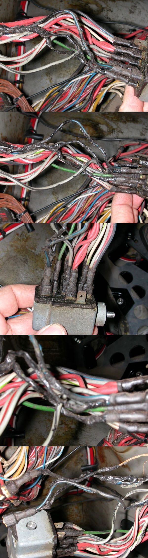

Holy CRAP!
Well, it seems that I have some melted wires... Both wires to terminal 58a and the wire to terminal 58b have lost their smoke. This is DAPO work for sure - standard electrical tape, and the liquid variety spread around to try to reinsulate this mess has obviously failed. These circuits appear to be for the instrument lights and 58b routes back to fuse 7 which also powers the license plate lamps. Looks like I've got some work to do.
One tidbit - I tried removing fuses one by one. None had any effect except fuse 9. Pulling that got rid of the symptoms reported before, including engine running with the ignition off and lights on.
Phil - all wires appear to be connected normally at fuse 9. Do you think the shorted wires from the switch could be the entire problem? Or should I be looking elsewhere also?

My advice is to re-wire as necessary back to the factory configuration, all the time ensuring that each wire goes where the diagram indicates. Keep the new/repaired wires separated loosely.
When reappling power, do it in a few seconds bursts, all the time eyeballing the wiring for
smoke. If there is no smoke and everything works, hey, your in fat city. Then you can tie up the bundles neatly. I will be in to inspect later.
