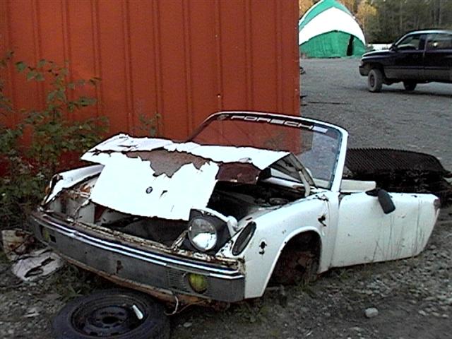

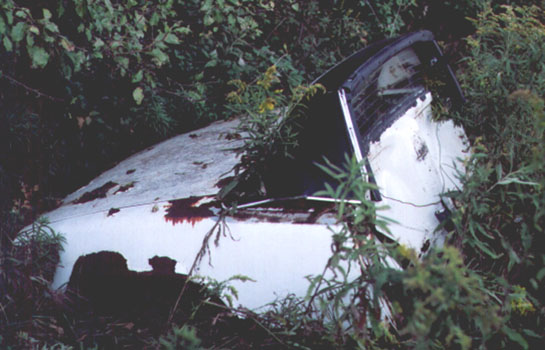

From: Port Hope, Ontario
Member No.: 26
Can't be that bad....The teen I got my early SSI's off of was rusted right into the ground. The mild steel flanges were rusted almost right off.
Hot tanked them and TIG'ed new flange's and they looked like new.
the wreck they were found on..... (IMG:http://www.914world.com/bbs2/html/emoticons/ohmy.gif)

Hey Mark, you found the other 1/2 of my car. I still have the serial number from the front half.
