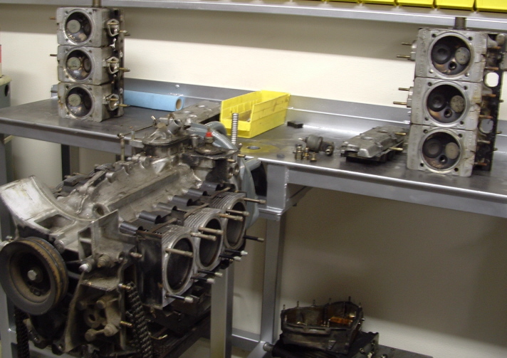

fresh update, Eddie get r done

post Mar 4 2006, 07:31 PM
Teenerless Weenie
Posts: 8,373
Joined: 5-July 04
From: Western Mesopotamia
Member No.: 2,304
(IMG:http://www.914world.com/bbs2/html/emoticons/w00t.gif) Jeez what a difference...
Looks really good.

what happened to the DME?
carboz look great
sixnotfour
post Mar 4 2006, 11:49 PM
Posts: 10,904
Joined: 12-September 04
Member No.: 2,744
the guy Eddie purchased the motor from sold the manifold, he has everything but the mani, So he is going to use the carbs untill he finds a mani for a decent price.

This engine is so beautiful with the Webers, that it might be a shame to install the DME. ITBs?
