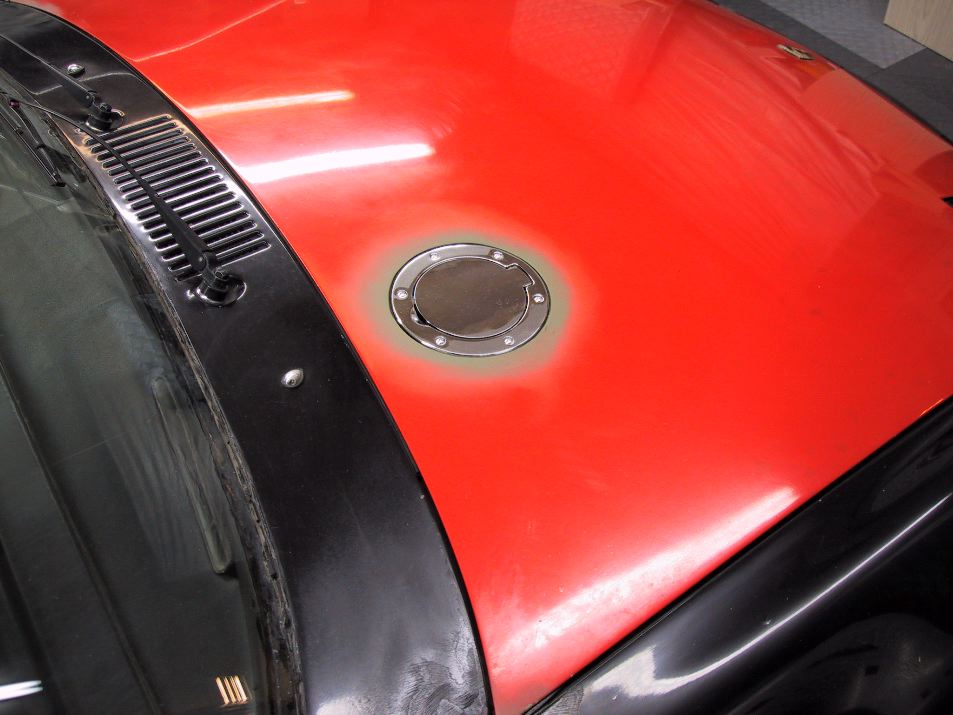

Take a look at this one.
I think with some reall good measuring, you could make this work...not the way it works on a motorcycle tank, but the idea...
Im thinking that the cap should be accessible from the outside, but look flush...try to blend it in.
Hotch Gas cap
Rich

This fits my theme better (IMG:http://www.914world.com/bbs2/html/emoticons/wink.gif)
