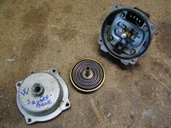

Ive delt with a bitchen miss thats driven me crazy for way too long. (about a year after a dropped valve repair) Ive read many posts and followed many suggestions and found many small fixes (some of I woudl have bet fixed it). Ive rebuilt the FI harness, soldered the relay board, ohmed every part and Tstat sensor. Cleaned and tested TPS and Triger Pts. Intake vac at 20" at idle. All new Ign OEM wires plugs etc.. No points (eletronic) all in distributer. Idles good reves good but crusing speed bucks. (the TPS tracks I bent arms slightly to start a new track then ohmed all). And the intake temp sensor is unplugged (runs way bad with it) MPS checks great both Vac and ohms. Sealed settings never touched.
Symptoms now idles good reves good but hold the throdle steady almost anywhere off idle and it sounds like massive ign failure.
I just pulled the plugs to check them and they look snow white. I turned the fuel pressuer up did not seem to help. I experimented on the MPS and made up a test I unplugged the hose from the MPS and stuck a vac gauge on it reading the intake, then used my new hand vacuum on the MPS.
Here is what I learned. (following all related to MPS controled by the hand Vacuum) If holding vacuum 15" w/n start right and starts fine at 0 vacuum as in normal cranking conditions. At 0 on the MPS barely idles, At 15" on MPS idles great. But at 20" on MPS idles bad (20" is my intake vacuum at Idle) Well then I went for crusing mid range rpm held the throdle missed like mad slowly pumped up the vacuum on the MPS from 0 and could tune out the miss totaly by adjusting vacuum to the MPS.
Helped eliminate my ign problem I thought I had. Running so lean and 90%RH in the air sounded like an ign breaking down. Problem alot less noticeable during dryer weather.
Seeing how I could tune out my miss using vacuume on the MPS I decided to open er up. My 72 has been stored longer than it was ever used. First thing I noticed was grease. Oil migrated and solidified in the control. I unsoldered the coil and cleaned it out. I removed the check valve like disk form the vacuum port and cleaned the grease from it. Mine had a smaller check plate and spring built into the disk and it was stuck! (first problem I found) I did not touch the sealed adjustments or the mystical sealed disk where all the adjustments rest as it vacuum test perfect. The next minor problem I found was the core stop arms had pad like things at the tips one missing and one falling off. I glued hard drive jumpers on the ends that touch the ever moving core. Reassembled and vac test perfect and tried it out exact same results no better and luckly no worse.
I am going to remove the glued on pads and try it on the car again, as they wrap all the way around the arms and add about 5 to 7 thousandths of an inch to the arms width. Im gona go with no pads and light touch on the shaft core with a touch of lube.
And as if to add to my confusion I tried an MPS in the car that has a terrible vacuum leak (wont hold for 10sec ) and is the wrong number all together for my system and my car runs great compaired to the OEM MPS. WHY??
Im leaving the bad MPS on for now. I would love to get this thing working right. Without spending alot on parts that dont cure my woes.
Should the MPS be sent off to a pro to be tested and set to specs on the bench or adjusted in the car with an exaust analyzer?
Pls HELP, advise me of any experinces (Good or Bad) any have you have had with the real brain to the Djet EFI system the Manifold Pressure Sensor the MPS.

The mid range is in my experience a bad mps.
I found oil in mine as well...it seems that it could be from either to much positive pressure in the intake, or the high vacuum.
I get a 2.0 liter one, stole the diaphram and put in in place of the 1.7 liter diaphram, all settings the same...I did not turn any screws etc...
So I now have a 1.7 liter body, plugs and scews etc...but a 2.0 liter diaphram.
It runs perfect now...
I chased this for a few years...

To answer you question as to why the "doesn't hold a vacuum"mps works better is that its running way richer than the sealed oem MPS. Once the diaphram is cracked or torn and it doesn't hold a vacuum, the MPS is figuring that you have less engine vacuum.
Idle is about 15hg of vacuum on a engine in good condition
Partload is anywhere from 10 to 4hg of vacuum
Wide open throttle is 0hg
So the "bad" MPS is not able to register the idle vacuum (15hg) properly so it is thinking its only maybe 10hg which needs a richer mix.
The first thing I would do on your car is use a good vacuum gauge to see what you engines vacuum readings are. You should be pulling a steady needle at 15hg.
Next, check for vacuum leaks using a little squirt of starting fluid aimed at the likely suspects, throttle body, seals, hoses etc. Leaks will raise the idle rpms

Thanks Bleyseng for the reply. The oil in my OEM MPS was solidifying in the MPS internal check valve as well. In my first statment I where I finally realized it was my MPS and not the ign system or relays or relay board or ign switch or FI harness or TPS or Trigger points or fule pressure and all the leads I have followed for a year was by simply putting a new vacuum gauge on the intake MPS port and an hand vac on the MPS. At idle intake port at a steady 20" (high?) and pump the OEM MPS to 15" and it idled smooth but pump the MPS to 20" as the intake port gauge reads and the idle gets rough. Then when I hold the throdle to a higher rev it for midrange miss Im having I can use the hand vac on the MPS to totaly eliminate the miss. Like setting an adjustable jet on a carb I could use the hand pump to go above and below the sweet spot where my miss was gone.

The oil in the MPS is from it being run in a worn out motor where the ring blow by is high. Lots of internal pressure will force more oily air into the plenum where the MPS will recieve some as its vacuum hose in located there. Oily air inside a MPS isn't good.

I would suggest that the wrong MPS that you have may be an early type4 VW mps...this version had no diaphram.
It was the first version of the MPS that was manually adjusted, but I believe it would never hold a vacuum...not sure, but without a diaphram it would have a hard time.
It was adjusted by a longer allen head screw...it had a wide range of adjustments...
So, have you taken the original mps apart and fixed it?
Does it hold a vacuum?
If so, and if you have the correct meter...you can set it yourself.
Get it setup for your car. the 1.7 runs rich..its ok.

You know I never looked into a ECM for this car ...analog worries me for older cars like ours. IMOP analog signals can degrade for sooo many reasons related with age...even inside the ECM...but then again I am rambling (IMG:http://www.914world.com/bbs2/html/emoticons/smoke.gif)
Wadduya say ?
Later
(IMG:http://www.914world.com/bbs2/html/emoticons/beer.gif)
PS ... oh ya...have you thought about a temp repair by installing a small bleed off in the MPS hose. I used to play with wastegates like that.
