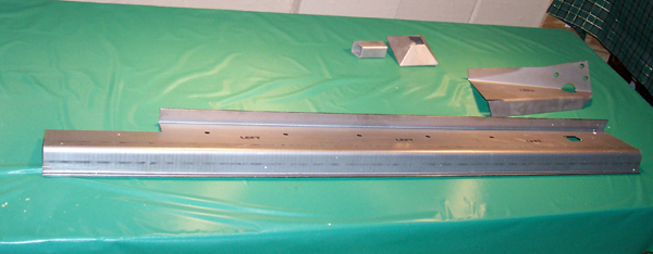

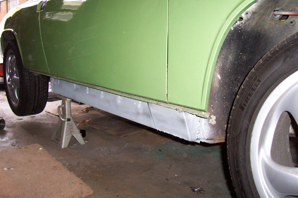

Here you can see the section, very strong..

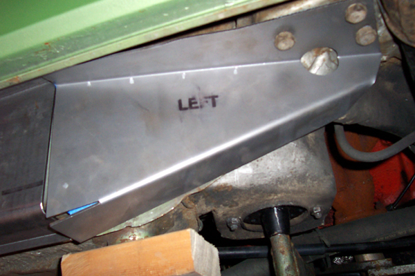

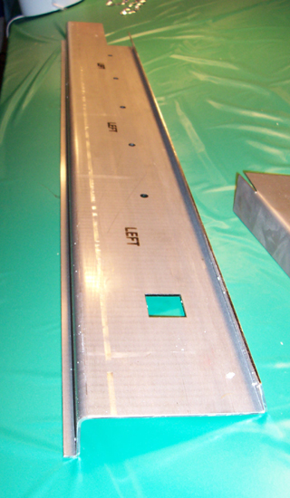

Here is how the two pieces fit together..
I marked where I am going to drill and plug weld to the chassis, I think you are supposed to weld along the top, but I just can't reach in there.

You can trim around the box section if it is strong...

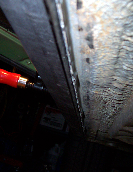

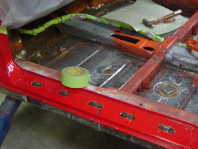

Here is how the downstanding flange mates with the kit, fits well, here it should be stitch welded.

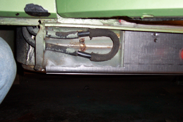

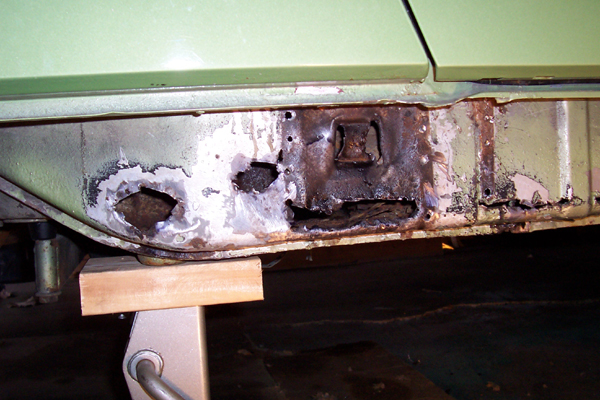

This is why I started this project, pass side was a bit rusty. I patched the holes before I installed the kit on the pass side.

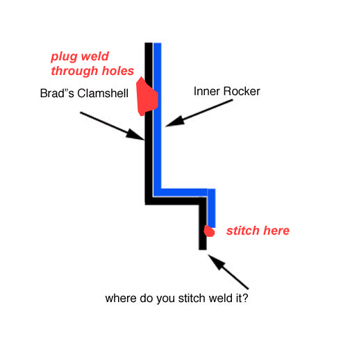

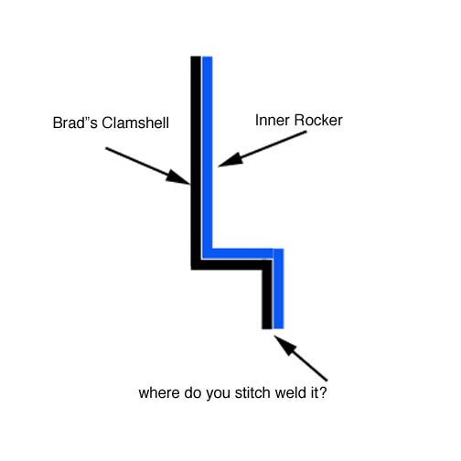

New to welding. What does stitch weld mean? I will be installing Brad's Reinforcement Piece as soon as I finish my inner log repairs. Do you have any other pics of how you welded this area?

dkos:
Stitch welding is when you weld for a length, leave some without and weld some more, like a stitch:

OK...I get it...like a stitch with tread. I can see where you would stitch weld two pieces that butt up to each other or overlap, but I don't get where you stitch weld the bottom length of Brad's Clamshell to the inner rocker?

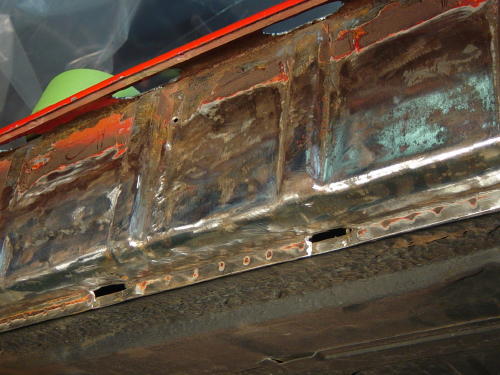

Here's where to weld:

The thing about this kit is it supports the outer suspension mount better than any other kit out there. Engman's kit is good, but it doesn't do anything for the suspension mount. If you've got serious corrosion and you aren't going for concours perfection, this is a great way to go. It's also really good for high horsepower cars.
Here's a pic of one of the installation "deviations" I do when installing this kit. It helps alot, and Brad likes the idea too. The "windows" are to weld the longitudinal stiffeners to the vertical ribs. The holes are covered by the sill plates. The other thing I do is to grind off the weep holes instead of crushing them flat. I'll post a pic of that too.
