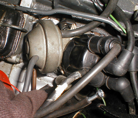

jimkelly
post Jan 9 2006, 05:07 PM
Delaware USA
Posts: 4,969
Joined: 5-August 04
From: Delaware, USA
Member No.: 2,460
pic
Rand
post Jan 9 2006, 05:09 PM
Cross Member
Posts: 7,415
Joined: 8-February 05
From: OR
Member No.: 3,573
two questions - is the advance port on the dashpot the one closest to the dist or the one furthest and on top of the dashpot the advance port. Also - do I plug the hose coming off the advance port of the dashpot or do I leave it open to the air.
Your questions have already been answered... (IMG:http://www.914world.com/bbs2/html/emoticons/wink.gif)
Disconnect the hose going to the advance fitting on the distributor dashpot (that's the one pointing away from the distributor body) and leave the other end of the hose open to the air.

Captain wrote opposite Dave - I had to ask despite feeling very confident with Dave's reply. Also the advance hose plugged or unplugged seesm to be not fully in agreement but again I am going with what Dave advises - but want to thank everyone for their replies!!! Jim
Rand
post Jan 9 2006, 05:39 PM
Cross Member
Posts: 7,415
From: OR
Member No.: 3,573
Gotchya...
I have read the factory left it UNplugged.
Not sure how much it matters.
