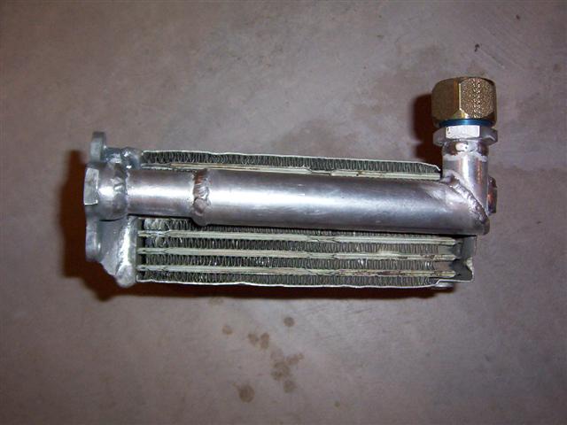

Luke M
post Jan 15 2006, 08:28 PM
Posts: 1,416
Joined: 8-February 05
From: WNY
Member No.: 3,574
I got my cooler mod. done for $60.

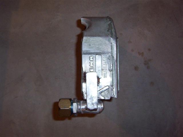

Luke M
post Jan 15 2006, 08:29 PM
Posts: 1,416
From: WNY
Member No.: 3,574
One more.

ditto what Rich said.
You might also want to go to the Smart Racing Products website. Read what they have to say about oil line size and the use of an inner support coil on the suction side of the pressure pump. Basically their recommendation is -16 with a support coil 3.2L case/pump and smaller. 3.6L case/pump -20 with support coil. Also never heard of an accusump being used with a drysump.
That's quite a bit of welding to convert that oil cooler. I don't want to dis your setup, but wouldn't it have been easier to just weld on a straight male AN and then use a 45 deg AN fitting off of the oil cooler? That's what I did on my car.
