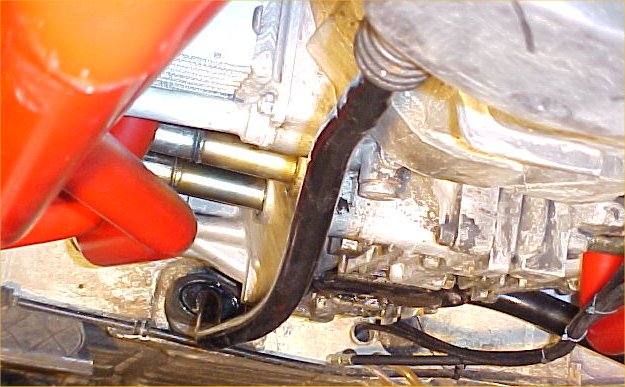

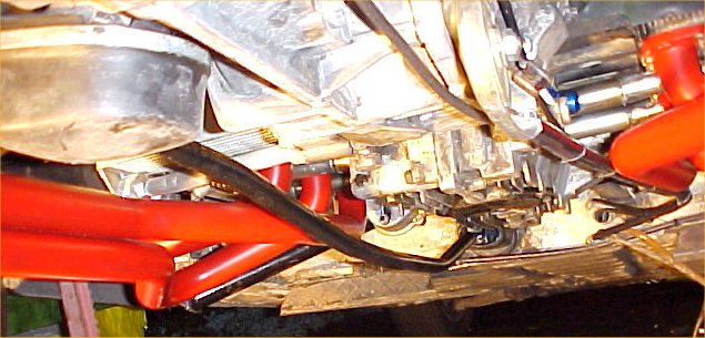

Back when I did mine, the first thing I noticed is that the stock shift rod for the FOUR is *very* bent. I works fine very bent.
I just cut mine at both ends and rotated the bend downward to clear the headers. Something like 60 degrees IIRC.
The shifting action feels exactly the same.
here's a couple of pics:

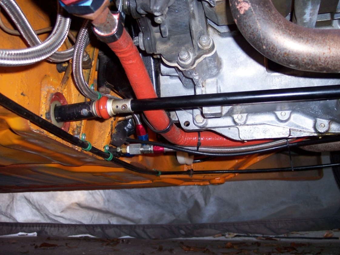

Another pic:
KT

John,
I made mine straight,it seemed the simplest way to keep it simple.
The tube is 4140 I got from Mcmaster,and i Apex coupling up front.It seems to work just fine.
Heres 3 pics to show.
Ron
RON S.
post Feb 14 2006, 06:19 AM
9140430841, FINALLY RUNNING
Posts: 1,216
Joined: 22-May 03
From: WALTERBORO,S.C.
Member No.: 724
#2
center section
RON S.
post Feb 14 2006, 06:24 AM
Posts: 1,216
Joined: 22-May 03
Member No.: 724
Last one,
Tail section,
Ron
