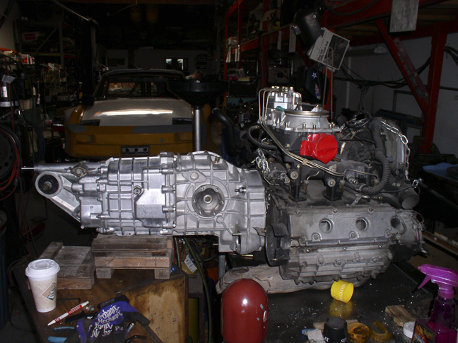

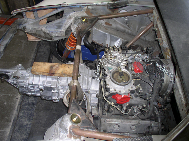

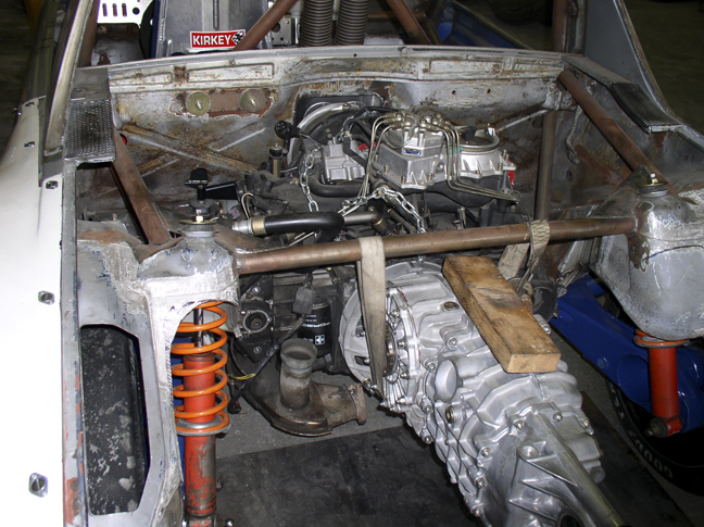

You're right Don, to run a G50 mid-engined you've got to flip the whole thing over. Fortunately it isn't too hard to convert, but those things are BIG! You will most likely have trouble getting a G50 into a stock tub, but if you are willing to do a bit of surgery in the rear trunk area it'll go. (IMG:http://www.914world.com/bbs2/html/emoticons/sawzall-smiley.gif) (IMG:http://www.914world.com/bbs2/html/emoticons/welder.gif)
I'm not sure that you'll need that much beef though. I think the 915 would be plenty (The overhung 5th isn't an issue), and the four speed 930 would surely be enough to handle any "moment of weakness" that you may suffer. (IMG:http://www.914world.com/bbs2/html/emoticons/cool.gif)
If you aren't familiar with Patrick Motorsports check 'em out here:
http://www.patrickmotorsports.com/
They convert all of the various gearboxes for 914s as well as a cable shifter system that is absolutely fantastic. Not affiliated with them in any way other than being a very satisfied customer...
BTW, here are a couple of pics of the flipped G50/52 'box in my turbo race car project. It was modified by Patrick to run inverted and with a shortened bellhousing. The G50/52 is a bit longer than other G50s, but not by much. Either way, you can see that it's a pretty tight fit in a 'teener!

'Nuther shot...

One more, just fer fun...
