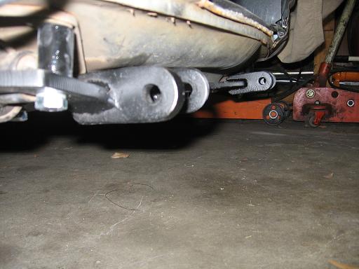

A few more pics.....
dlee1967
post Feb 28 2006, 11:24 PM
V8Lurker
Posts: 540
Joined: 20-February 03
From: Splendora, TX
Member No.: 327

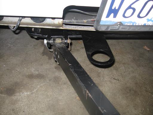

Two...
dlee1967
V8Lurker
Posts: 540
From: Splendora, TX
Member No.: 327

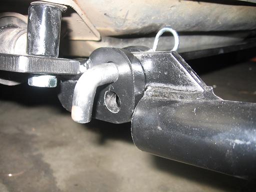

Three...
dlee1967
post Feb 28 2006, 11:25 PM
V8Lurker
Posts: 540
From: Splendora, TX
Member No.: 327

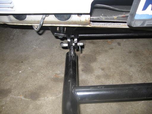

Four...
dlee1967
post Feb 28 2006, 11:27 PM
V8Lurker
Posts: 540
From: Splendora, TX
Member No.: 327
Welded race eye option shown on a Reese/Drawtite style bracket. Eye can either be welded or bolted.
