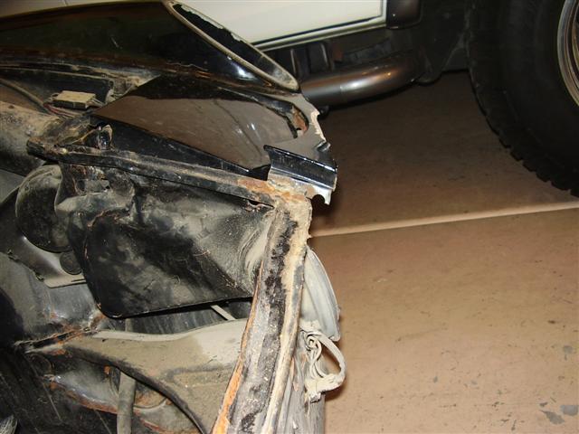

is it possible for a good body man to replace the front of my car with a donor front , also would they be similar enough donor 1 72 my car a 74?

Yes it's possible. The only real difference between the '72 and the'74 is the arched support in the front. Other than that it should be a good swap.

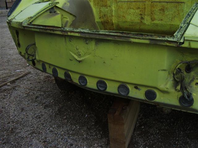

thanks for the reply. i saw your post about the same thing a few years ago? how did it turn out? heres another pic

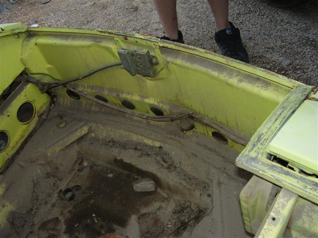

another
rezron
post Mar 13 2006, 10:10 PM
Posts: 327
Joined: 25-December 02
From: Mason City, Iowa
Member No.: 10
It's turning out good! Just give me another week and I'll know more!!
I decided to take a good share of the front apart and repair what I have!
It takes time but it should turn out fine. I should have been all done by now but felt the need to build my 3 stall dream garage/shop so I had big setback on time and money! I should have it together by warm weather.
rezron (IMG:http://www.914world.com/bbs2/html/emoticons/wacko.gif)
