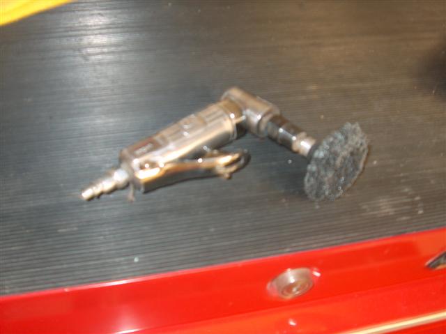

I bought myself a compressor and el cheap tool kit. I was kind of hoping that the cutoff tool would be the right thing for cutting out the cancer. Had a go at it today but this tool was useless. No torque at all - stalled with very little pressure - hardly any sparks. There is an adjuster on it that seems to throttle the air supply. Played with that a bit but it didn't really make any difference.
So do I have a faulty tool or just the wrong tool for the job?

Is the compressor putting out enough pressure to run your cut off tool? I seem to recall my cut off tool required alot. Check the cfm output on the compressor an see how much the cut off tool requires.(IMG:http://www.914world.com/bbs2/html/emoticons/smile.gif)

(IMG:http://www.914world.com/bbs2/html/emoticons/agree.gif) what size compressor do you have??? you need a whole lot of pressure to run a cutoff wheel, and it runs out quick with a small compressor.... I like body saws.... small and quick....but the small blades break easily.. (IMG:http://www.914world.com/bbs2/html/emoticons/cool.gif)

Cutoff tools and grinders need a LOT of air. You need a serious compressor to drive them. Look at CFM ratings, they're the most important when dealing with tools like this. With my compressor, I can run the tool for maybe an inch or two cutting sheet before I have to pause and wait for the compressor to refill the tank.
A Dremel works well for some areas. Buy the fiber reinforced cutoff wheels. You go through them fast, but the cut is quick and smooth. The brown-colored cutoff wheels are pretty useless for cutting steel. They break apart way too easily.

Don't think it's supply problem. The compressor is a 5hp 20 gallon that is suppose to do 5@90. The compressor recovers pretty quickly after I shut off the tool and the lack of torque is from the get go.
That wont supply the air you need. I had a 5.5hp 30 gallon craftsman that couldnt do sh*t.

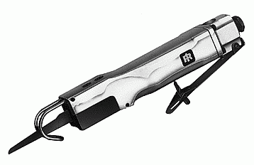

This is the Saw that I use, Ingersol Rand model 429....
I too have a smaller compressor, I've been using it since 1983, it is a 2 horsepower, 20 gal. tank, 2 cylinder, and it runs on 220v, Mike is right about the size needed, however, I added about 60 feet of 1 " schedule 40 Pvc from my compressor, which routes up the wall and into the attic of my garage, then back down the other wall to the filter/regulator, then I run about 40 feet of rubber hose, and for the most part, my compressor keeps up with the tools that I use. I think the extra storage seems to help. (IMG:http://www.914world.com/bbs2/html/emoticons/smile.gif)

cheaper than the IR saw, I am getting this one:
Eastwood saber saw
