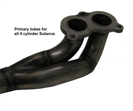

So far, my impression from looking at pictures is that the available Subie headers make too gentle a bend as they come down from the exhaust flange, ending up about as low as the stock oil pan. Not a problem in a Subie, but for us that's getting awfully close to pavement. Although sharp bends are usually undesireable, right near the heads they seem to be less of a problem. Also, I have no idea how they relate to various engine mount bars that people are using.
