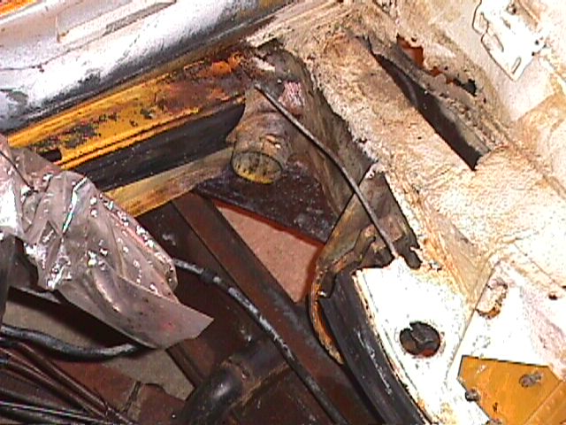

Here is a picture of what I had to cut out. With the battery tray out I found more rust. The picture doesn't show all that I cut out before I repaired it all but it gives you an idea of the work involved in trying to do the repair with the tray in place. (IMG:style_emoticons/default/blink.gif)
Trays are cheap and yours probably needs replacement if it never has been yet.

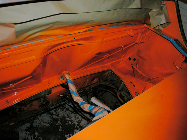

post Sep 18 2003, 08:12 AM
Canadian Member
Posts: 2,083
Joined: 15-January 03
From: Timmins, Ontario, Canada
Member No.: 153
And after the repair.
