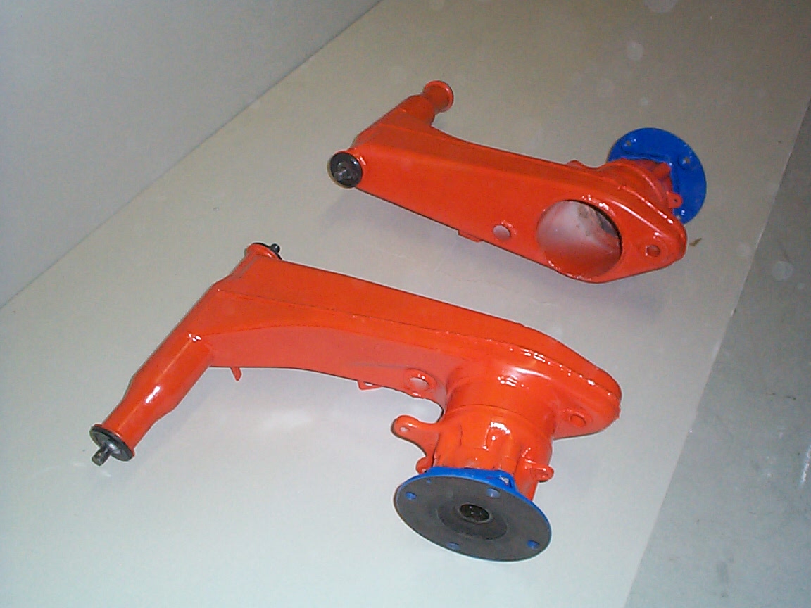

O.K. I have new delrin bushings installed and seems like I remember they stuck out a bit beyond the seration on the pivot rod end. At the time I figured knuckling down on the nut would be enough to catch the serations? Here's what it looked like;

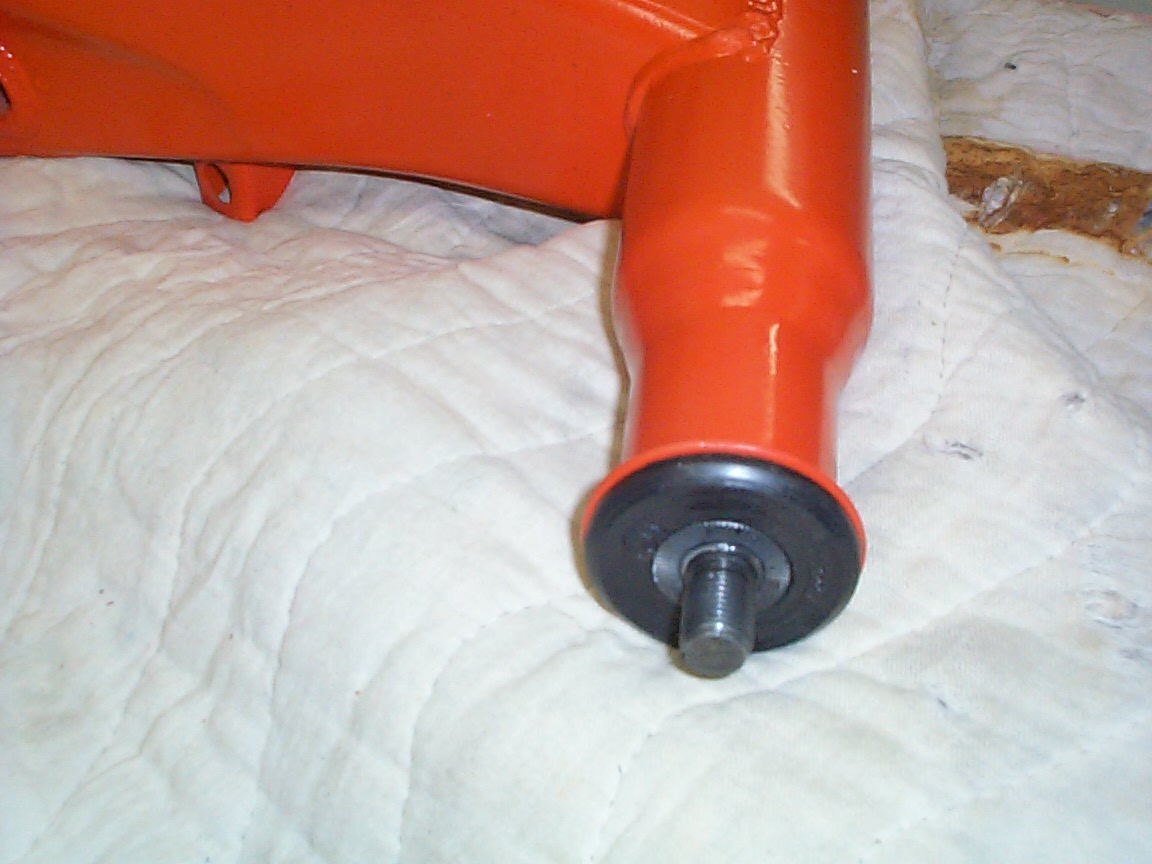

root
post May 17 2006, 12:55 PM
Two Wheeled Type4 Completed!
Posts: 849
Joined: 5-May 04
From: Sterling, VA
Member No.: 2,026
Pressing in the bushings. I used polycarbonate tube peices so I could see the
bushings seat;

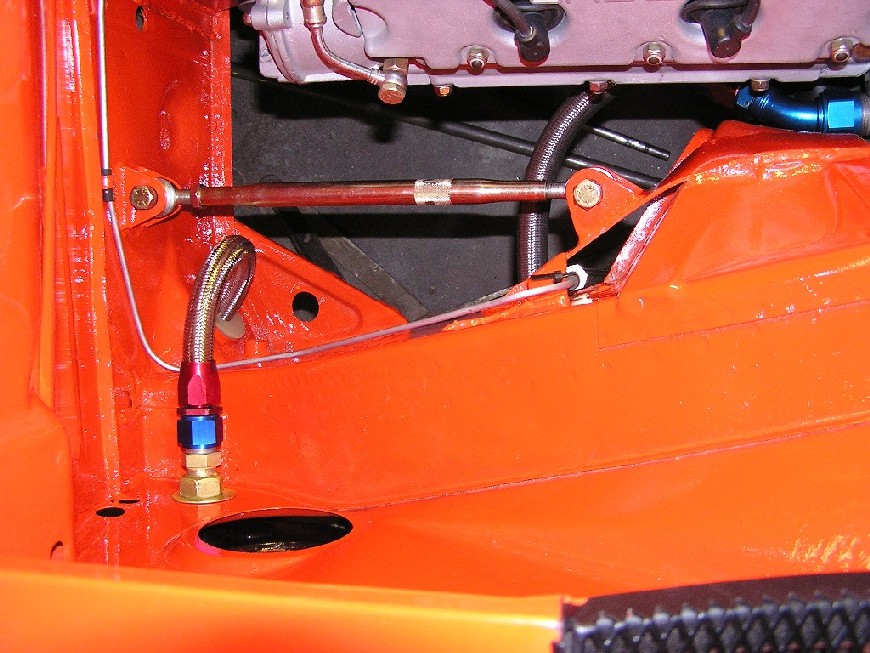

my -4 cylinder version is smaller and less intrusive.
but here is the basic idea:

brant
post May 17 2006, 09:14 PM
Posts: 12,167
From: Colorado
Member No.: 47
I have the toe change brace too...
but that is not the reason your swing arm mounts are coming loose.
its the inner one that flexes and allow's the loosening....
look under the chassis some time.
the frame is straight down the longs.
but when it gets to the swingarm mount it turns sharply.
a TON of leverage is being applied (side to side) on that single bolt.
its the inner one that flexes....
by triangulating the inner one to the firewall you are adding LOTS of strength and bracing....
no one believes me... thats fine.
I like being faster and right.
wait until you have all dealt with a ripped console and then you will reconsider.
the nut comes loose from flex.
(10 years of reality testing proves it... Plus my guru has proven it on 15 other cars)
