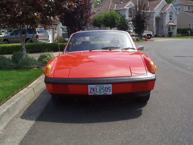

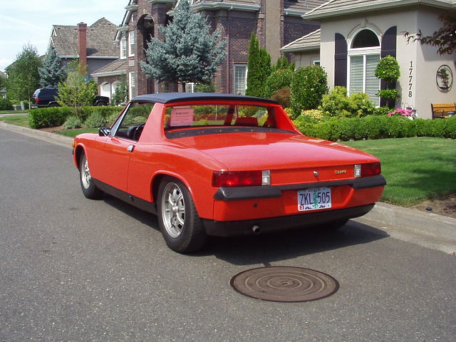

Porsche Rescue
post May 25 2006, 03:17 PM
Saving and Enjoying Old Porsches
Posts: 2,978
Joined: 31-December 02
From: Bend, Oregon
Member No.: 64
Here is an example of a standard early car ('71) with body colored bumpers. As mentioned above, the standard bumper in later years was flat black. Chrome was an "appearance group" option until '75 when the bumpers you are backdating arrived as mandated by the feds. Sail vinyl was also optional as part of the appearance package in the early years.
