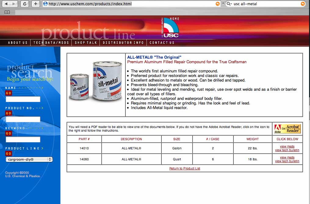

dkos
post Jun 6 2006, 03:03 PM
say, "RUST"!
Posts: 295
Joined: 1-December 04
From: Philadelphia, PA
Member No.: 3,204

dkos
post Jun 6 2006, 03:15 PM
say, "RUST"!
Posts: 295
Member No.: 3,204
QUOTE(tdgray @ Jun 6 2006, 02:04 PM) *
I use all metal exlusively... look in progress thread.
It is ground alluminum. It is impervious to water and will not shrink.
You cannot buy better stuff than this.
Even better it is made in Canton OH... right near me.
HIGHLY Recommended.
Todd...awesome progress thread...I'm buying a can of All-Metal today!

dkos
post Jun 6 2006, 03:23 PM
say, "RUST"!
Posts: 295
Member No.: 3,204
link to USC (makers of All-Metal) website: <http://www.uschem.com/products/index.html>
